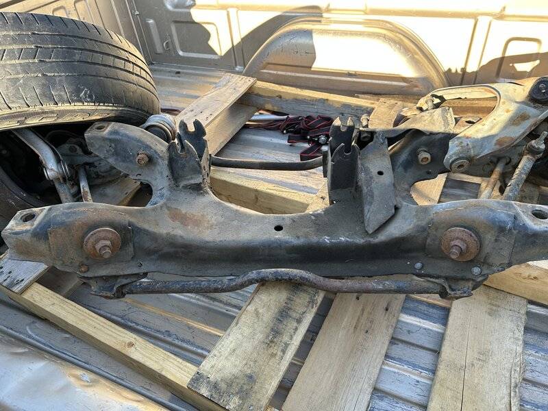

Need some help, trying to big block swap my new duster. Found this K frame for sale locally, owner says it’s out of a 69 barracuda. It’s obviously not original because of the spool mounts.
Sorry for the crappy picture, does this look like a DC big block K frame? @Jim Lusk

Looks like a small block K frame to me based on the engine mount locations.
Interesting that it’s set up with the earlier sway bar too. The 73+ K frames have the better design, the sway bar running through the K saves a ton of ground clearance and the engine mounts are a better design that doesn’t constantly fail like the cheap biscuits. Picture is pretty lousy, can’t tell if those mounts were added or not. A picture of the bottom of the K would show if it’s 73+ or 68-72 with the spool mounts added.

Not at all. For a big block conversion the best thing running other than a DC spool mount K is a 73+ slant 6 k with conversion mounts. I forget exactly what extra clearance that gets you but it saves at least one clearance modification to the K frame. And the better mounts, and the better sway bar.
It looks to be an original DC BB k-member. The mounts are moved back.
Compare the front left mount tab to the hole in the brace going front. The front tab is even with the hole on a small block k-member.
The tab on the one pictured looks back to far to be a small block . The big block left mount is back 1 3/16 the right side is back 13/16 . They looked to be moved back and were not cut and rewelded like the home made k-members.
Hmm. I see what you’re saying, the drivers mount appears like it could be further back than for a SB k member.
But quite frankly I think the quality of the picture makes it pretty difficult to tell even that much, let alone if it’s a DC k or some kind of homebrew. You can’t see nearly enough detail for that. I certainly wouldn’t assume anything beyond it looks like a spool mount V8 k frame. Without a picture of the bottom side it may not even be 73+, could easily be a conversion.
The pic blows, that’s what you get on Craigslist from an old timer. But the old timer had the DC K member so I’m glad I made the trip.
Nice find. came with 73 center link plus 67-72 stabilizer a lower control arms. How much did you steel it for? LOL
Shoot, man...I have a 73-76 K member that was modified for a big block and I would have made you a deal !

U can tell it’s for a big block as the drivers rear mount ear is back past the steering box mount. A sb is pretty much inline with the steering box mount. Kim
Agreed, but the quality and angle of the original picture makes this pretty difficult to determine just from that picture.
