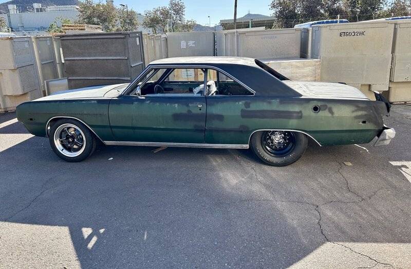

I currently have a 74 dart thats going to be a street strip deal (this uses spool mounts on the k member)
8.50 cage (nothing ties into the engine bay)
4 link
sub frame connectors
torque boxes
welded k member
512" nitrous big block
727 w/ brake
at what point should i be considering a mid plate/ motor plate? if i use poly motor and trans mounts with a torque strap and something to control the motor moving forward and backwards is that suitable? they dont offer solid mounts for these cars.
or at a certain level is the motor plates necessary? i don't know the limits of the spool mounts on these cars. id like to know what guys doing 1.10-1.30 60fts are using
thanks

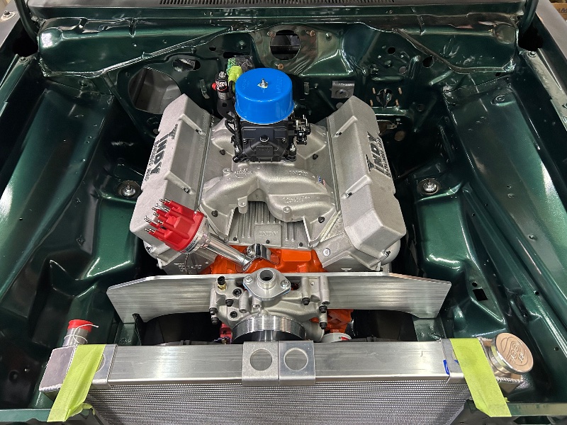

I got the front plate in along with the radiator, got all of the taillights installed (finding those were a nightmare) im taking it back to my friend next week to do
-down bars for front plate
-anti roll bar
-exhaust
-ss coolant hoses
will post pics when those are done. Just been buying parts and waiting for an opening. Then we start wiring and fuel lines
we actually only did the front plate and left the midplate out. when i was mocking everything up it looked to be a nightmare and would have to do a lot of cutting and would need to basically push the headers/exhaust out of the front fenders. Front plate tied into the cage and poly spool mounts will work for now and we will revisit if the car gets faster. looks like alot of guys run a front plate and trans mount only lol so i feel ok about it
