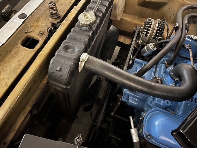

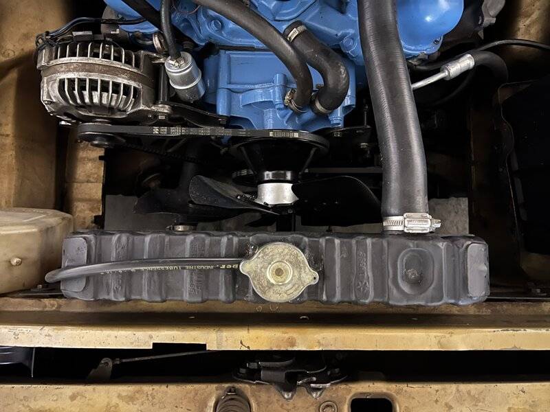

My brothers 1972 Swinger came original with an 19“ radiator wich works perfectly. He wonders if it came with a shroud.
3574637 19“ AT non AC
Thanks in advance.

My book says 72. 318 with manual trans. They also did not have a coolant recovery system bc so the tank and cap had been added on. What’s the number on the tank? Kim
It has a transmission oil cooler.
The tank is not original.
We removed it today.
The Swinger was built in Canada for France.

I had a 19" radiator in my 70 Swinger. It was original to the car and was a 318 car. Mopar started using the 19" radiators in 318 cars back in 69.
Without shroud and overflow bottle I gues.
Exactly. Overflow bottles weren't used until later in the 70's. (not for sure when) no shroud either. I have Dealer installed Chrysler A/C that dod not include a larger radiator. :BangHead: :BangHead: With a bad cap it would puke coolant on hot days.
Just 2 rows
So a 2 row 19" copper brass radiator can cool a SB engine without a shroud. Sarcasm to follow...Who would have thought! I thought you had to have a 2 row 1.5" tube aluminum rad with dual electric fans and a restrictive shroud to cool a SB!
