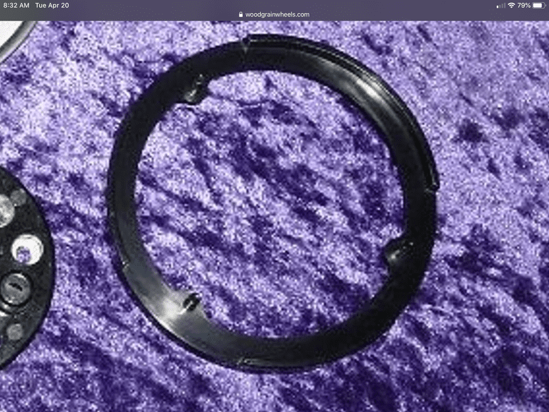

The 70 column is larger diameter than a 68-69. The 3 holes are to mount this plastic ring. It fills up the gap from the larger diameter column, then the satin finished horn Switch mount is different on a 70, it has a larger base diameter to line up with the column.
You can use a 70 wheel on a 68-69 if you remove the black plastic ring from the wheel and use the 68-69 horn switch mount.

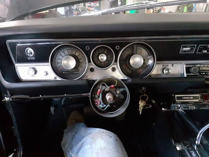

Hi, my steering column looks like this, I have the standard 68 barracuda steering wheel. If I want to install the woodgrain really steering wheel what should I do? What parts do I need?
- steering wheel
- horn adaptor
- horn pad
what else is needed for the swap?
