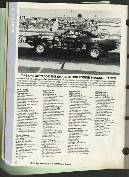

They were very good books. What he has posted only scratches the surface. Mopar really knew how to support racers back in the day.
yes they did . now u have to kind of hunt but if u follow the bilds in the catalogs from the old days it will run
now the part #'s have changed but the imformation is still good . it is too bad u can shair emails ,or fb id, mewe, or telgram i have a lot of stuff . too much to send here

I really wish that the engine book and the chassis book were available as a pdf file. I have those books but they are falling apart.
I agree the info is still largely valid today. The info will still guide through what you need for a certain performance level. I followed those books for years.
I built a BB bracket car, 71 Dart in the 80's using the MP Chassis book as my bible. Was a consistent 6.30 car that worked perfect.
They are like a recipe book. You picked a speed you could afford and simply follow the recipe!
Yes, and all those recipes, though dated, still WORK, yet people just ignore them and wonder why their junk is slow.
Absolutely! In this day and age of bracket racing, it is more important to build a sold consistent car, than it is to try and build the worlds fastest___________( fill in the blank). You can take the MP 9th edition chassis book and do just that. I ran that 71 Dart 4 seasons before selling it to build the 67 Super Gas car in my Avatar.
I've been mulling over picking out a recipe from the engine book and building one. Step by step part by part. I'd have to have a custom cam ground since they aren't available anymore....
As was said, the part numbers are long gone but the recipe just needs valid substitutions.
That's right! I believe Jim at Racer Brown can purt near duplicate the MP grinds.
