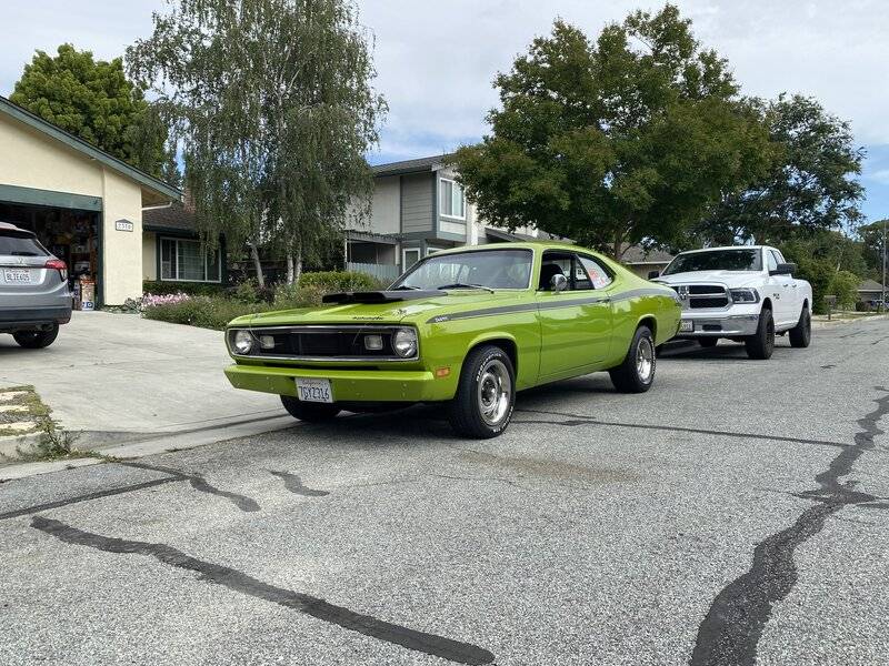

Hey guys, looking to upgrade the disk brakes on my 71 duster. It has spindles and disk brakes from a 76 dart now but I want to upgrade to a better system since I drive the car a lot. I’d definitely like to keep my 15 inch rally’s also. What all do you guys recommend in terms of brands youve had experience with. Thanks!
