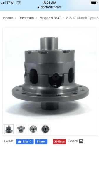

I am in need of a new Sure Grip section for my 489 case 8 3/4
Does anyone have experience with the Sure Grip replacement that the Doc is selling for $395 ?
Or has anybody used one his $185 ring and pinion sets?
Thanks in advance
Thanks in advance
