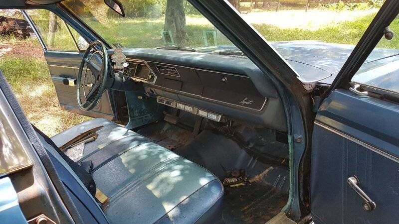

Had a 69 valiant here with radio delete and AC. No hole in fender and the plug for radio was on the harness.
Ok, thanks everyone for the information. So to summarize for future generations who may be looking for this info 50 years from now to restore their 100 year old Mopar... A radio delete car around these years had a dashboard delete plate, a radio plug in the harness behind the dashboard, a radio slot in the fuse block, no antenna hole on the fender (or a plugged antenna hole), nothing blocking the dashboard speaker hole, and a speaker hole in the back deck metal structure, but no speaker hole in the back deck fiberboard.
The "delete" plate is integrated with the heater control face.
