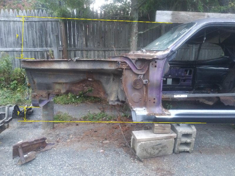

I admire your desire to rebuild some absolutely beyond reason, but you are going to have serious problems if you dont at least put that thing on a flat concrete pad. You CANNOT do what your attempting on dirt with cinder blocks for jack stands. You probably have allready welded twist into the chassis by welding your rockers on with it sitting like that.
Well I jacked it up like that, welded the brace in the door frame, took some measurements, and the replaced the rocker. And the door frame geometry didn't move at all. I'm going to test fit the door today. With 1/4" factory tolerance I think it will be ok.
I'm only one of a long lineage of shade tree mechanics that have been repairing cars in the dirt for a hundred years and ending with a good result. Sure, I'd love to have a frame jig and 60,000 square foot garage with a shiny floor, heat, and six lifts like some forum members have, but that isn't going to happen in this lifetime.
Oldmanmopar said he has a full body jig for A Bodies that correctly locates all the frame rails. Maybe he would lend it to you?
All good info, thanks; but I already planned the baseline for the requested measurements, not off of being level, but off of the factory body lines themselves. For example, I laid a stick on the roof and then brought that line forward to the rad support. So the car can be on a hill and I'd still get the same dimension. The same with the other two measurements too. For the cowl line and rocker line, I wasn't leveling anything, I was only continuing the factory lines forward! So all these lines should be the same on all cars, especially since the factory manual says that tolerances of 1/4" is ok.
Right, but a "stick on the roof" isn't an accurately repeatable measurement. You're pulling a straight line off of a curve and measuring a distance with an angle on it. You have no way of knowing if that "stick" is level, and if it's not the measurement won't be repeatable. If I do the same thing but the stick is got a tiny bit more angle on it, the measurement will be totally different. And, oh yeah, the factory didn't tolerance the radiator support that well.
There's a reason why the factory chassis measurements are taken the way that they are. They are all based off of square, level surfaces so that they can be accurately reproduced. You have to be able to set up the reference points, otherwise the measurements are meaningless.
And just because the factory said the body measurements were within a 1/4", well, good luck with that. They aren't. Even if they were, the body lines being right doesn't necessarily mean your suspension points will be, and the suspension points being right is all that matters. The bottom of the radiator support that you use as a reference could be different by a 1/2" and it would effect nothing. The factory doesn't use it as a reference because it wasn't held to a strict tolerance.
And even if they did, how are you measuring that? The rockers are wider than the radiator support. So you're projecting a line forward, using an imaginary point, and then shooting a measurement line off of an imaginary point over to the bottom of the rocker? You've got no way to square that imaginary reference point, so, if any of the angles are a fraction off the measurement is useless.
Agree 100%. It would be one thing to change a single frame rail or other component like that, at least you have the rest of the car to use as a reference. Not best practice, but at least reasonable. But with that car he's got no reference points. None. Too much metal missing already. That means the references would have to come off a known surface (frame table, or yeah, at least flat concrete) to get accurate locations. Clearly our guy hasn't done any drafting, machining, construction, etc where you have to use dimensions established off a known reference point.
Right, except you could have moved the entire door frame up a 1/4" and the door would still fit. But now the rockers in the wrong place. Just because the roof line stayed the same shape doesn't mean it didn't move, not with the amount of structure missing from that car. You can stick the door on a fully assembled car if you jack up the front corner on one side only, there's too much flex even in a complete car for measurements like that to be accurate.
I'm only one of a long lineage of shade tree mechanics that have been repairing cars in the dirt for a hundred years and ending with a good result. Sure, I'd love to have a frame jig and 60,000 square foot garage with a shiny floor, heat, and six lifts like some forum members have, but that isn't going to happen in this lifetime. View attachment 1716463138
Look, I've done lots of work in the dirt, or in my backyard, or on a driveway that is most decidedly not flat. And that's fine, MOST of the time. When you do chassis work, you MUST have references that you can repeatedly measure accurately. If you replace one frame rail, you can do it in the dirt, level the chassis and use the rest of the chassis as your reference and measure one spot on the ground etc. and it will work well enough. Not ideal but you can make it work.
You have ZERO reference points with the body you have there. None. Nothing on that car can be trusted to be in the right spot. Which means you MUST have a known reference to establish the chassis measurements in the FSM, bare minimum. You don't need a 60,000 sq foot shop with lifts, but you do need at least a flat section of concrete large enough to hold that car so you can drop plumb lines and set your references to establish that "o-line".
Hell, I supposed you could frame up a "floor" with 2x4's and secure it on your ground surface there, and set that up so it's level and square like they do a raised foundation house or shed. Basically use that as a frame table, it wouldn't hold the chassis but as long as it was square and level you could use it to drop plumb lines to. Not how I would do it but at least you'd have half a chance at having some reference points.
In the ideal world your info would work great, but in the real life, establishing the O-line on any 55 year old car is just a guess. This is because you can see from the factory diagram that the O-line IS the centerline of the wheels. So the manual doesn't specify, but I GUESS these dimensions from the wheel centerlines to the frame (which moves up and down in relation to the wheels) are based on a fully loaded car (engine, transmission, interior, etc.etc. etc.), because the car WILL move up or down depending on what type of weight is on the car. So that blows the O-line dims right out the window. Also, what type of front and rear shocks are we talking about, and torsion bar tensions?? All those will affect the dimensions from the O-line to the frame points on that diagram.
So in the end, lets throw the dice on the imaginary O-line with movable dim distances, or throw the dice on taking three sticks and doing three simple vertical measurements. (Btw, if you lay a long stick on the roof, it doesn't wobble, it sits right sturdily on the roof as if you were laying it on a flat table).
Still looking to see if someone has a skeleton laying around that he can take these three measurements off of. Thanks.

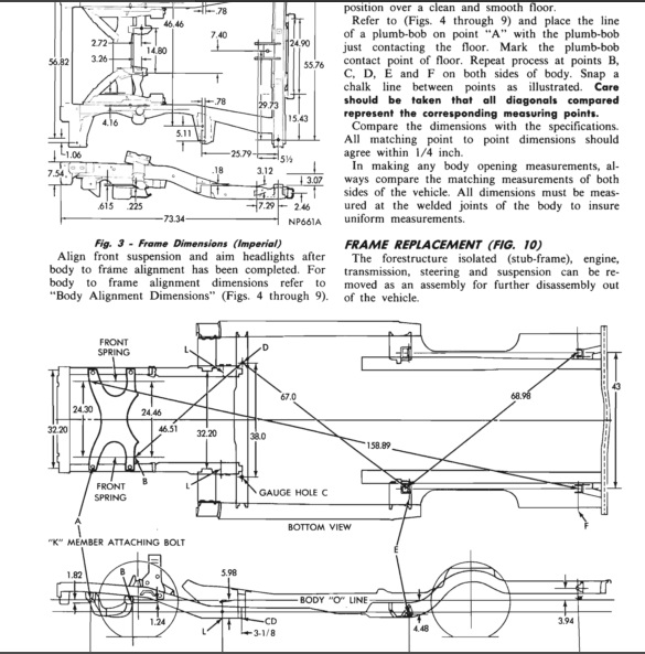

Nope. All the dimensions you need to establish the 0-line are clearly marked and it’s not a guess, the geometry is clear and repeatable.
All completely irrelevant. I’ll say this again, all the dimensions needed to establish the 0-line are clearly marked in that diagram.
That’s a chassis diagram. None of those measurements are ride height dependent. There’s a reason the suspension isn’t drawn in, it isn’t relevant for the chassis measurements.
Yes, they indicate the axle centers for the wheelbase measurements in the drawings. They show them because the chassis measurements establish those locations, not the other way around.
None of the dimensions in that diagram are moveable. The chassis dimensions set the axle location, not the other way. There’s no “roll
of the dice” to locate the 0-line, just math. Basic geometry.
Clearly, you don’t understand how to use that chassis diagram. Or why your measurements are in fact useless for your intended purpose.
Best of luck.

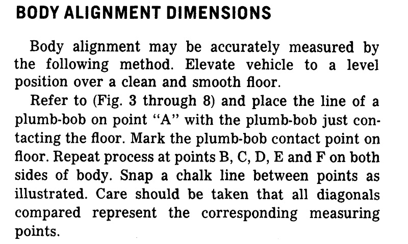

From the FSM, the proper procedure for using those measurements

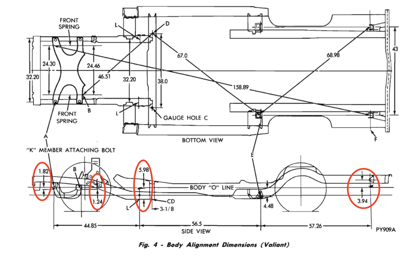

I'm sure you know that screenshot you took above is for horizontal dimensions, not vertical dimensions..
But anyway, just for information's sake, since you're saying the wheels have nothing to do with anything in that diagram, lets just delete them from the diagram... Then where is the O-line?
I literally circled the vertical dimensions in red on the diagram I posted before. I’ll post it again
The 0-line is exactly in that same place. 3.94” below the center of the rear shackle mount, 5.98” above the bottom of the front frame rail at the torsion bar crossmember measuring point, 1.24” above the rear K member bolt and 1.82” above the front K member bolt.
Yeah, I know, your car doesn’t have those 3 front points. But it doesn’t matter!!! If your car is on a level slab, you measure down from the rear shackle hanger to the floor. Let’s say you put your car 3’ in the air (this is an arbitrary number!). So it’s 36” to the O line, so the center of the shackle mount is at 39.94”. Now, you move forward. The 0 line is at 36”, the measuring point at the frame is 5.98” below that. So 36-5.98 and you need 30.02” from the floor to that measuring point. Now your crossmember is located, and you move forward and do the same process for the front rails at the K frame bolts.
But you’d need a flat and level surface to drop plumb lines to in order to measure that. But you can’t seriously do this work without that, or a frame table. And then you’d need to drop the plumb lines and measure the diagonals to get it straight.
This is chassis work 101. That project of yours is a BIG one, because of all the reference points you don’t have. It should really be on a frame table because of that.

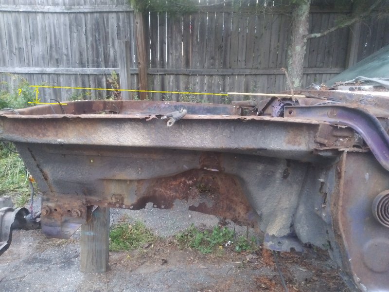

All arguing aside, since no one had the dimensions I was looking for, and also since my car is not on a frame rack or level floor, I may have found the solution another way. I pumped up the back tires to their normal psi then leveled the rear axle (from left to right), then put a level between the left and right rocker and leveled them (from left to right), then put a level on the top of the firewall and leveled it (from left to right), then put a level on the bottom of the radiator support and leveled it (from left to right). So that leveled the car from left to right. Then for the front to rear tolerences I hung the doors and fenders and slightly adjusted the nose up or down to insure that all the door/fender lines were uniform.
And so far it looks beautiful, all the fender mounting holes line up nicely, and also the spot weld holes line up with the new panels. I also am guessing that the weight of all the new parts on the front end will stress/weigh down the front of the car, so I'm building a slightly bigger gap between the doors and fenders at the bottom, that will close up uniformly once all the front end stuff is installed.
