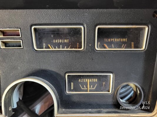

Does anyone make a factory look-alike VOLT gauge for 68 Barracuda dash?

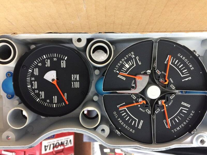

Redline can make it look anyway you want!! This is on my Cuda fast back. On my Superbird, the lettering was stock butvthe gauge was calibrated son that the pointer was centred at battery voltage.

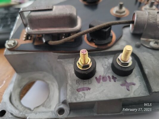

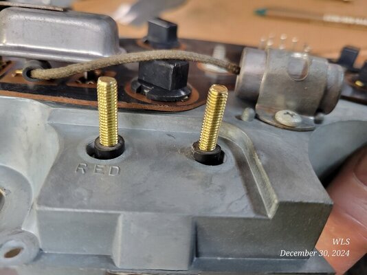

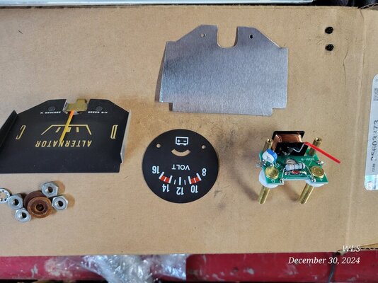

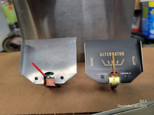

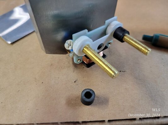

For my 1966 valiant I used a cheep made in china Volt gauge ( BX102440 ) as a core. The terminal posts were a little wider than factory Amp gauge. Still was able to fit in the cluster with out modifying. Well I didn't want to waste the working amp gauge, like I did in the past, so I made a new back plate that fits the new volt gauge. Used painters tape for the design then used model graphics from woodland scenics for the letters and numbers.The volt needle was short so I made an overlay that was super glued in place. Less than $50 for every thing. If I could yellow the white some it would mach the other gauges better. Of coarse custom made wiring under dash to complete the project.
