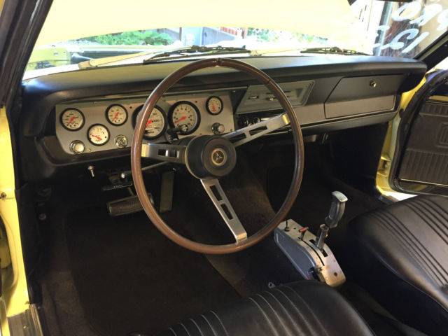

Does anyone recognize this dash?
lshore
New Member
Aug 1, 2013
4
1
Radcliff, KY
I'm researching 69 Dart dashes, and came across this pic on the Google, which says it's a 69 Dart. At first glance it appears to be a 70-76, but was wondering if a 69 dash had been modified to accept the boxier cluster panel. Does anyone know if this belongs to a member of this forum? If so, I'd like to ask some questions about the modifications. Thanks.
Aftermarket maybe, it isn't a rocky mountain. Note that the one in the OP pic is flat and recessed, not bent to the angle of the stock dash.
Pushbutton glove box lock button, and no padded lower pieces on dash. It's a 69 dash frame and glovebox door. Homemade custom made dash gage insert. Look at the heater control bezel. Looks like a stock dart bezel cut flat on the left side to fit the custom gages. Whoever did it, that's some nice work.
