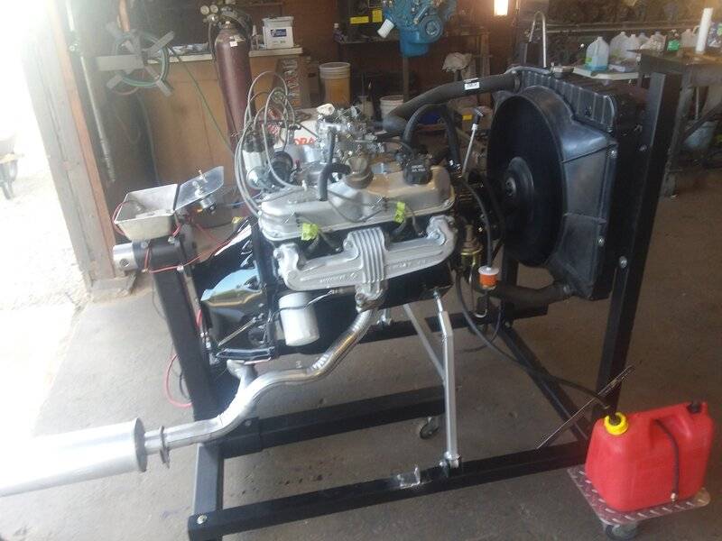

Hi Folks
I'd like to set up and use a run stand. What coolant would you use.....50/50 or just plain water?
Thanks
50/50 Sooner or later you will want to unhook and install in a car and you will need 50/50 there. The block will already be full.
I've got a mule 340 to use to set up my carb and ignition first, then the rebuilt 340 to run in the cam.
