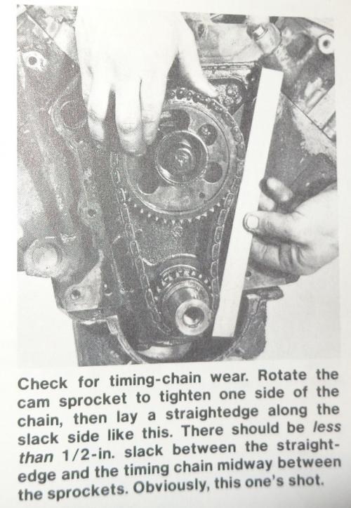

Here is how I was taught.
[ame]http://i968.photobucket.com/albums/ae170/obe1kanoby/Tape2_zps502f9d94.png[/ame]
You start here.
[ame]http://i968.photobucket.com/albums/ae170/obe1kanoby/Tape_zps78f98eb2.png[/ame]
You end here. On the same side of the chain. Not switch measuring one side of the chain to the other. You include the width of the chain otherwise.

Here is a pic showing your illustrated method. I am showing about 3/16" without pushing on the chain with my finger. Add 1/16 when I push on it making 1/4" deflection.

Did anyone see the strait edge version picture? 3/16 & 1/4" when pushed away from strait edge.
Is this alright? Parts are new and cam as stated is degreed. Is 3/16 to 1/4" acceptable?
