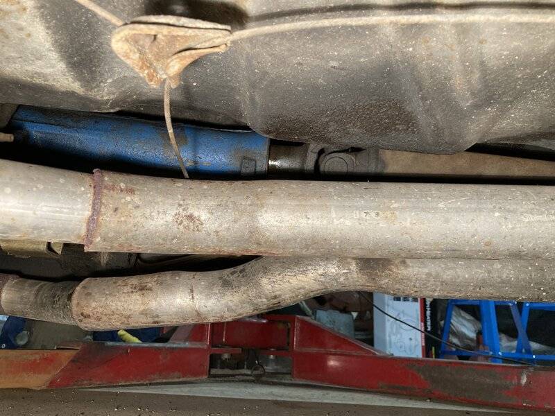

Just installed my new Espo +2” leaf springs. My pinion angle just got worse... no fault of Espo. Previous owner matched perch angle of the 7-1/4 he took out (supposedly) cause it was a B body 8-3/4. So I will be chasing some driveline angles throughout because the transmission to driveshaft angle goes upward (don’t ask how cause I don’t know). Car is 1972 Duster swapped from slant 6/904 to 340/727. So its using swap mounts for the engine to K frame. Using a 73 spool trans mount but I bought a 72 trans mount to swap in so easier to shim transmission.
So before I start shimming rear axle how many degrees of pinion angle does everyone have? Im about 5 degrees down at the front currently. I know all cars are different and rake affects that angle. Anyway, considering going with 6 degree shims and them with raising back of transmission that might work?? I’m confused... maybe.
5 down compared to what?? Where is the engine/ trans centerline angle at this point?
Transmission angles down, driveshaft angles up off the transmission, but downward to the pinion, which is nosed down.

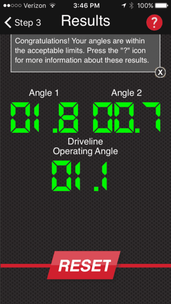

When I finished my transmission driveline conversion I double checked it with this tremec app. It’s easy to use and lets you know if your inside or outside a good angle range. Every car’s a little bit different. As 67dart273 said...you need to know your engine/transmission centerline angle to establish any base line changes. Lots of good info here for sure. Use the search tool and get ready to read. Good luck.
https://www.tremec.com/menu/tremec-toolbox-app/
Ya, i downloaded the tremec app, favorite app ever. Sadly my car is so screwed up my eyesight is more right. Cause first angle was in the green but it is going the wrong way... the others are red...
THIS MAKES NO SENSE WHAT IS the engine/ transmission centerline compared to level?
What the driveshaft is doing does not mean squat. You want the pinion in relation to the crank/ transmission centerline. So you measure that compared to level. You measure the pinion compared to level. And you figure out how many degrees down the pinion is compared to the crank/ transmission.

I had all the angles on the tremec app but forgot to screenshot it so I lost that and the car is not parked at my house cause Dad has a 2 post lift and I don’t so it’s there.
memory serves me the engine and trans are 4 degrees tail down, driveshaft 2 degrees, and pinion 5 degrees nose down.
in tremec app I know angle one was around 2 degrees and angle two around 7 degrees
