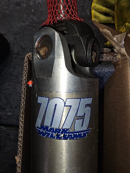

On a relate note, I never though much about checking the critical speeds of a driveshaft. After the installation of an overdrive transmission along with running higher gear ratios 3.91's and 4.30's didn't raise any red flags. I figured I'd have wheel spin before loading enough torque to twist a driveshaft without running slicks on a track, so I used stock style driveshafts. I may not have used a tapered one, but a regular 3" one anyway.
I like to stretch the legs on my Mopars from time to time, and started feeling significant vibration as speed increased. Then I did the math, 6000RPM/.67 = 8955 RPM and well over 150MPH. Stock driveshafts, especially long, tapered ones could easily be pushed beyond critical speed.
When it came to ordering a new driveshaft, my choices narrowed significantly. I didn't realized how high the rotational speeds where getting with overdrive higher gears and higher speeds, and how close I was getting to the critical speeds of "normal" factory driveshafts.
I ended up with a 52" Mark William's 4" aluminum driveshaft with 1350 U-joints and forged yokes. The critical speed on this specific unit is 8549RPM, so that will more than cover it.
isn't 8955 greater than 8549???? Or do you NEVER get that fast?
No, I generally try to keep it under 100mph on the day-to-day, so 197mph is above both my pay grade and capabilities in my Mopars. I've only maxed out the 150mph speedo's in both my Mopars a handful of times, but I'm not done yet!
Now THAT is what I’m talking about. You sir win the cookie for today.
