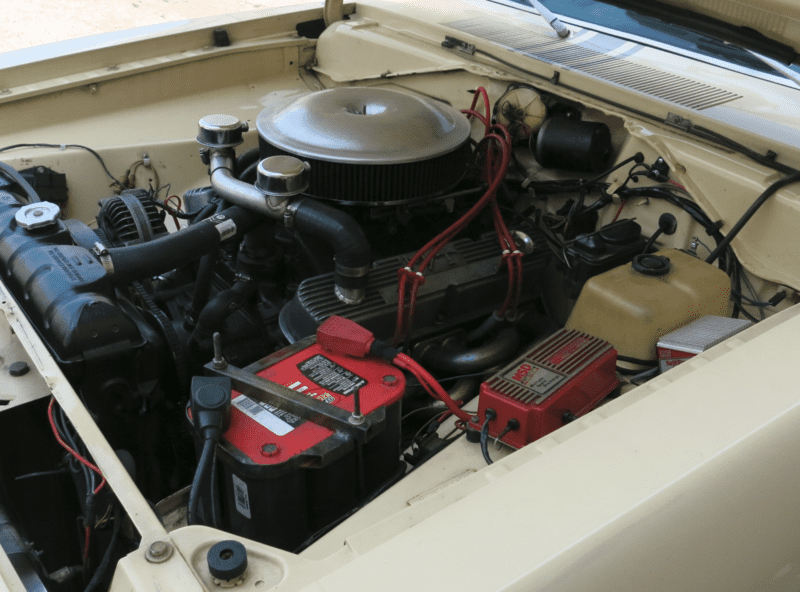

This is what I'm thinking of for a project of mine...
I've had problems with a drop base not flowing enough air and pulling fuel from the vents. But this will flow all the air needed.
