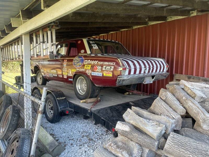

Hello, long-time reader and first-time messenger. I am looking to convert my front drum to disk and upgrade my front suspension on my 68 Barracuda. Does anyone recommend one kit over the other? Is Willwood the best for the price?
Appreciate the insight!!
