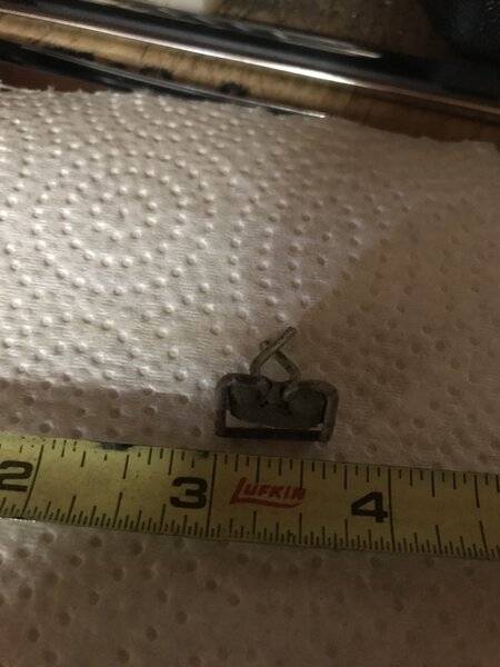

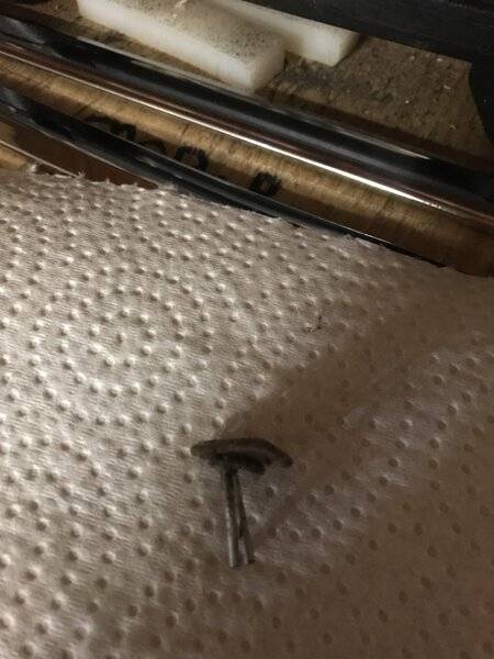

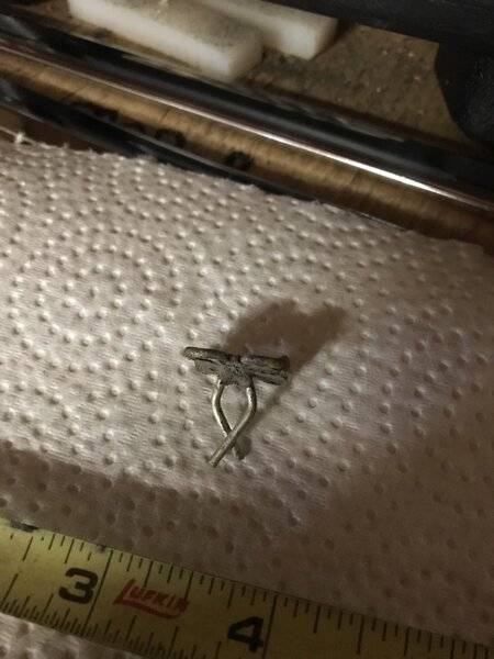

Thanks Oldmanmopar.Whenever you get a chance that would be great.I have most of the clips I think, one or two are broken.Any idea if the clips are still available?Perhaps used in another application?Thanks again

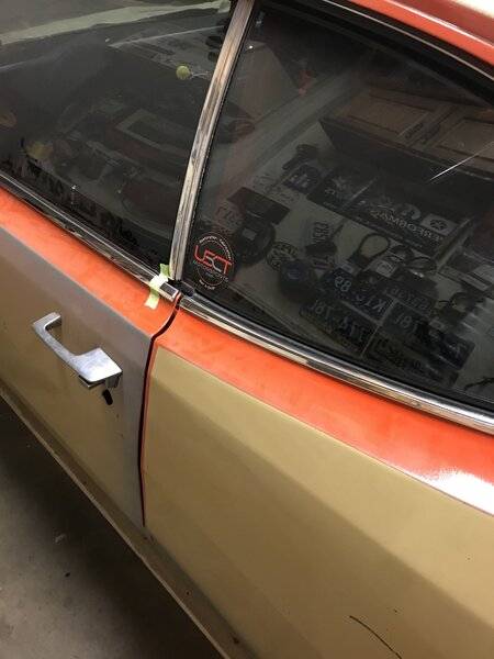

I don't have measurements, but I have these pictures saved a reference. They show the number of holes for the clips and the general spacing.
I would also imagine that there would be some factory variation as well, since these holes would have been added somewhere on the line. I'm sure a general guideline existed, but I seriously doubt every car that got them would have the exact same spacing.
Drivers side door
All holes were 1/4 from inside door edge
The numbers are measured from rear to front with the hole from the door edge center first
Front left door I measured from rear of door to the front
(1/4"- 40 1/2" < 1/4" - 36 3/16 < 1/4"- 27 1/4" < 1/4"- 20 1/4" < 1/4"- 14"< 1/4"-7 5/8"< 1/4"-2" ) from rear of door
<____________________________________________________________________________________________<
Left quarter I measured from front of quarter back Notice the last 2 holes on the rear of the quarter are farther from the inside edge
>from front of quarter (1/4"-1 1/8"> 1/4"-2 11/16"> 7/16"-11 3/16"> 9/16- 17 13/16")
>______________________________________________________>
These have been here for years all the holes were marked and measured with tape on body and placed on the trim. Remember the first number mostly 1/4 is the measurement from the door and quarter edge, The last 2 on the quarter get farther away. Remember the holes are drilled 7/32

Does anyone know where I can get the clips that hold it on?I have all of them but 2 are broken and a couple more are bent.Thanks
