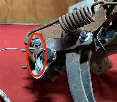

The switch just works off of a wire lever. And the switch housing itself should rotate a little where it’s mounted, so one way or another you should be able to tweak it so it activates the switch at the right pedal height. This is the lever highlighted here (not my picture, just grabbed it from eBay)
And the switch
And the switch

Maybe these photos will help. I’ll try standing on my head again to see if I can tell how/where the switch is bolted in place. It’s a poor excuse…but wearing glasses makes it tough to see what I’m doing in that tight (and upside down) situation.
