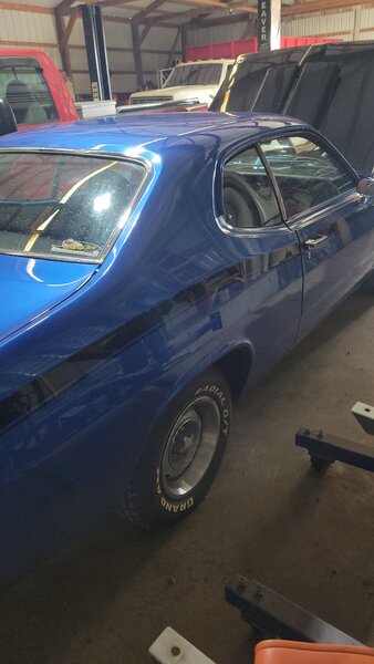

So my duster is running a little rich. 340 750dp. I know its not the best video but let's see what you think? Smaller jets maybe?
