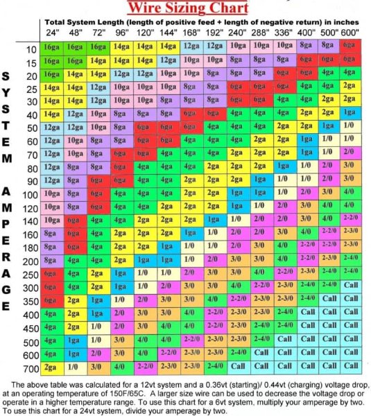

A few things need to be addressed:
1) You need a higher output alternator. Most alternators are tested at room temp. A typical unit loses 20% efficiency at operating/underhood temps. 70A nominal output isn't nearly enough. With two electric fans, MSD ignitiin, headlights, fuel pump etc. I was melting the varnish off of the windings on a 95A Powermaster. Do ensure that yoour operating RPM is within spec (i.e. <18k RPM). Powermaster sells a larger pulley for higher rpm apllications. A 5.5" crank pulley will also help keep the RPM down.
2) #6 power cable is undersized. I've attached a chart to help select the cable length. If your car has a floating ground system make sure to use adequately sized cable for the entire length of the power run.

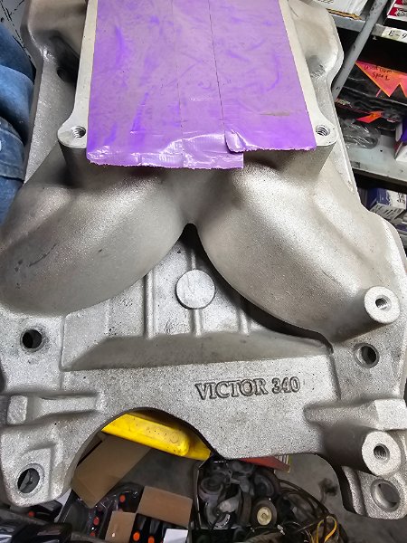

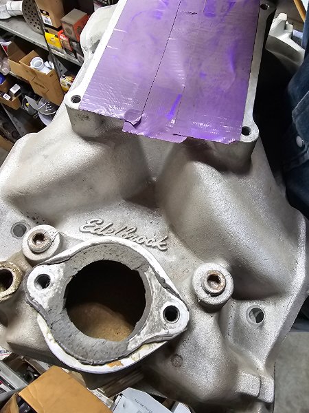

Vacuum is one of the issues Im trying to address. No ports on manifold, spacer or Carb.
Was going to drill and tap my spacer. Can you suggest another method??

What on EARTH intake doesn't have vacuum ports? Not even one?
And thank you for reinforcing the "why" behind the "way"!!
I would find what the minimum timing it will tolerate at idle first by just by moving the distributor. Make sure the distributor is not adding timing at idle speed through mechanical advance. You could easily add vacuum to the adapter or even the base plate of the carb. Closer to the throttle plates the stronger the signal. Holley? What model?
