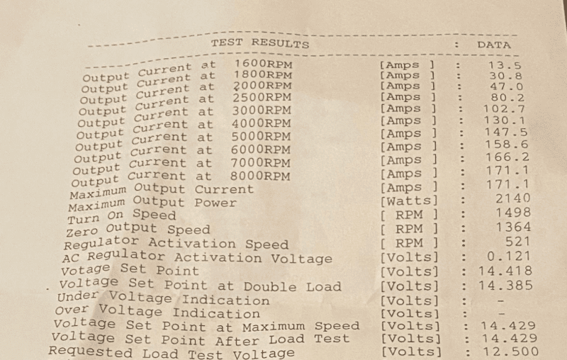

Anyways the alternator bench tested good (autozone) so I decided to upgrade to a 170 amp version and 4awg B+ cable thinking the 60 amp just didn't have enough to keep the fan powered at idle. The test report I received with the alternator states it puts out 80 amps at 833 rpms.

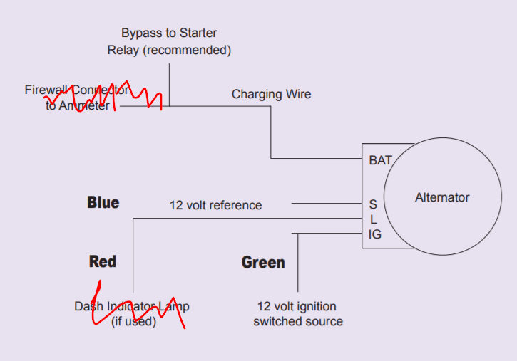

  • Sense wire to Starter Relay B+ terminal
  • Switched 12v IGN spliced to Electric Choke wire
  • Lamp - Not used
  • Ammeter Bypassed

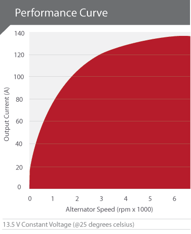

Pretty close to your output, this is a Denso graph.

I looked again at the test report and they used a ratio of 3:1 (probably correct for a late 80's 4Runner). 80 amps @ 2500 RPMs (alt speed) / 3 (ratio) = 833 RPMs (Engine Speed).
With my actual pulley ratio of 2:1, at my idle speed I'm only pulling about 30 amps...
