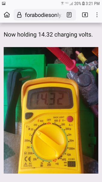

I just went round and round on Charging System Overcharging. Watched 20 videos on the subject, read everything on the subject and applied all the wiring diagrams.
Lots of experimenting with different components, all tests were massively overcharging.
'89 D100 with computer controlled Voltage Regulator that failed. As the whole truck is being converted back to "Old School" chose to go with mopar external voltage regulator, no joy.
Tried a motocraft Alternator with Ford external voltage regulator, no joy... over charging.
Came to the conclusion that some old wiring of the computer controlled truck was backfeeding causing the issue.
My fix ended up being intalling a 60 amp Motocraft Alternator and doing the ad on one wire voltage regulator kit, isolating the charging system from all of the '89 truck's original wiring.
Success, now I can get onto other more important things.
Happy with the results.

Thanks for the input guys. So far it seems that it is staying at 13.0 to 13.8 volts. I ground the back of the VR so that it would make ground on the firewall. Checked with my test light on the screws that mount it and everything seems grounded. If I find something else I will update again. Nice to be back here again as well.
