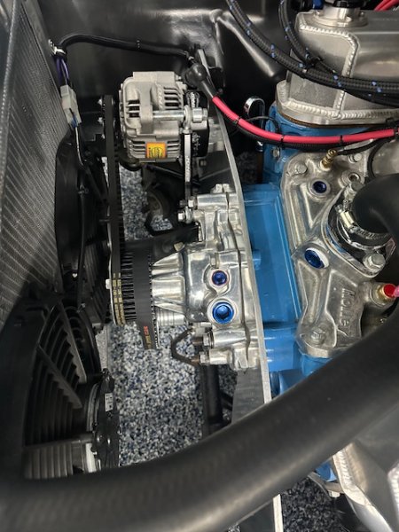

What model SPAL fans are you running?
Assuming that those fans are powerful enough to handle the cooling duties of your engine, they could easily be pulling 30 amps between them even after the initial big amperage hit to start them. Your 70A alternator might not even be putting out 20A at idle- you see the problem.
A second battery is just a band aid, it won't solve the issue. What you need is an alternator that puts out more amps at idle than what your fans AND other accessories put out.
If you have a brand new American Autowire wire harness, you're probably already running a single wire alternator (standard config for AA) and your system can handle a lot more amperage. I have a full AA harness, run a dual electric fan set up (Ford Contour) and use a 180 amp alternator. Like crackedback said, I don't need 180 amps, probably ever. But at idle that alternator is putting out enough amps to run my fans without discharging the battery.
And if your battery is in the trunk (mine is too), if you're pulling from the battery to keep the car running when the fans are on you have to pull a significant amperage from the battery though all the wire to the front of the car, which loses a ton of efficiency. Charging the battery is a low amp draw, so that's not a big deal with the battery in the trunk. Cranking the starter pulls a ton, but, that's a short period of time. The fans running is a large draw for a long time, and that trunk mounted battery, even with large cable, is going to take some work to pull amperage from.

Sounding more and more like undersized Alt....

That was my thinking. You said it's a 72? Amp?
Or just get the proper regular size battery that is up to the task. New not 1 to 3 years old.
Next 2 sizes are 80 at idle or 120amps at idle. Which would you go with.
I ASSUME you've upgraded the wiring. You said you have an AAW harness, right? Then I would choose the 120. Of course I am also assuming you have an adequate charge wire (it looks BIG) and it's also fused.

Ok, so a couple of things. First, it's the alternator. This is what I run, I think I said 180 amp earlier but it's a 165A. With the AAW harness and relays you shouldn't have any issues running this, although it looks like you'd need to look up the V-belt version, mines for a serpentine.
1974 PLYMOUTH DUSTER Powermaster 8-58529-103 Powermaster Street Alternators | Summit Racing
I also ran the 100A version of a Powermaster alternator with the contour fan set up, before I had the AAW harness. It was still set up with relays for the fans though.
The other thing is, I think you're at the absolute minimum for CFM with two of those fans. That's less than 2k CFM between the two of them. I don't know if that will be enough. I don't think it would be enough for my set up and the way that I use it.

It's just not the battery. His alternator isn't putting out enough juice to feed those fans, and with the battery in the trunk that means he has to pull that extra juice all the way from the trunk. The alternator goes to max draw, the battery has to get involved, and that's the 400 rpm drop. He already has the relays, it's just a matter of feeding them enough amperage. If it was just the battery, his fans would kill it and he'd be complaining about a hard start/slow crank issue in addition to the issue with the RPM drop that he has.
