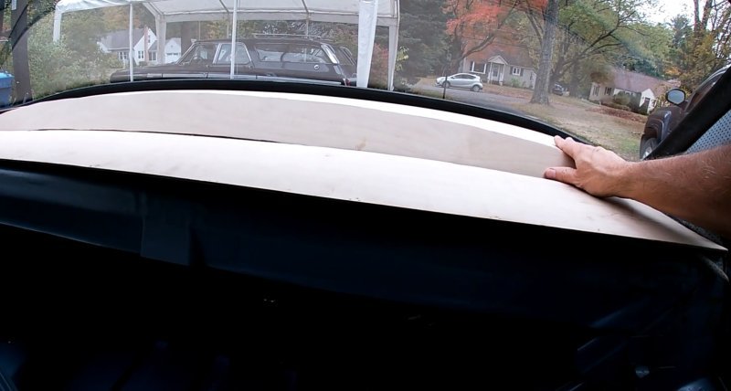

I made a package tray for my Valiant using very thin plywood wrapped with material from a craft store.
Plywood was very inexpensive, material was $17 for a half roll, which was more than what was needed.
