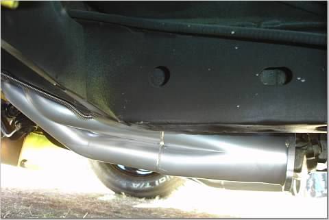

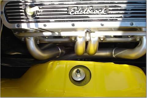

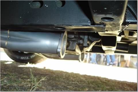

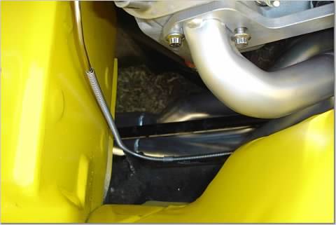

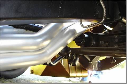

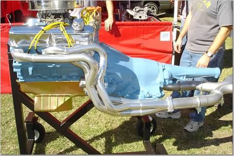

Ordered the 63-66 A body tti headers and 2.5 inch full X-pipe setup today at the Fall Fling. I did have to order the special made powermaster mini starter $240 :wack: Ordered it COD so I could check my flywheel size. I took a ton of pictures of the display and a 66 dart gt factory 4-speed with the headers installed. The display had 3" X-pipe. I am going to post all the pictures and I will post my install once I get started on them :headbang:

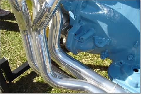

The cost was a huge hit (the 10% off at the show was nice) but I figure it is worth it after putting so much time and money into the engine and drivetrain already...... why skimp now on the exhaust. Not only that the exhaust pipes are already made to fit the early A-body. BTW the tranny mount does have to be notched out (they give you the plans to do this on your own) or you can buy theirs for $125 plus sending in your core mount.
IMO the extra $240 spent on the starter makes up for it in time spent installing ( less :banghead: ) Plus there is no welding, mandrel pipe bending and mounting to be done at muffler shop. That alone could set you back a pretty penny. Can do it in your own backyard now.
Everything sounds great right now but realistically I need wait until I install everything before I get all happy.
Dave

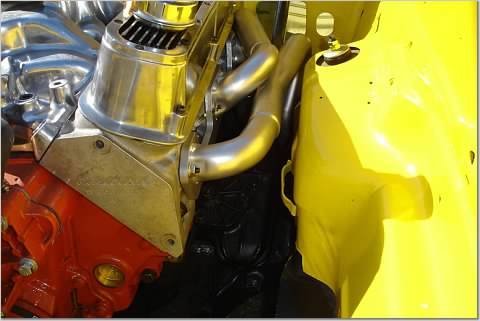

Passenger side

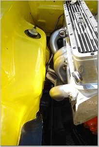

Driver Side

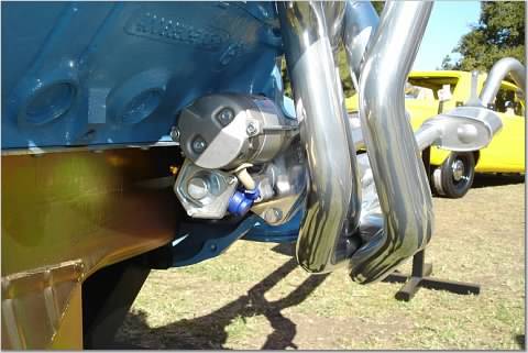

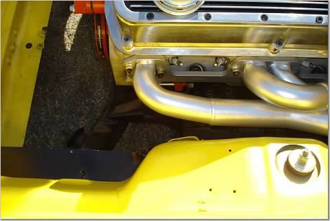

Mopar mini starter hits this tube and putting a dimple in it caused major reduction in flow
Next post will be the 66 Dart Gt with them installed

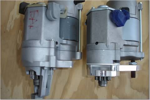

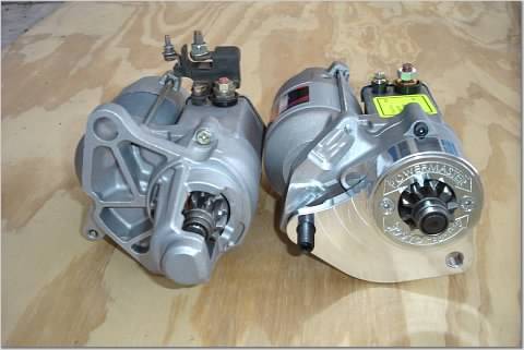

Okay so I took some pictures of the standard mini-starter that I had already gotten cheap from a junkyard when I was thinking of getting the Doug's or Spitfires. I compared it side by side to the custom Powermaster mini-starter made for the early A-body tti headers.
The starter motor bodies are exactly the same. :) The mounting flange is the only difference. For what it's worth: If there was ever a problem with the Powermaster starter going out, you could take the body from a standard mini-starter and replace it onto the custom mounting flange of the Powermaster. Seems like this would be the inexpensive replacement route IMO. It's too bad tti doesn't give you the option of just buying the custom flange from POwermaster. BUt that would be too easy of course.
This is just FYI for those of you who are thinking about the tti's and are worried about starter failure and the expense of replacing it ($240 smackers)
