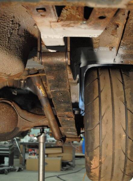

Still at the resto shop but these were them test fitting

How about some pic of that?
One piece of the shelf 15x8's?
Out of town til may , yes standard torque thrust big bolt 15x8 with 4.5 back space , about a 1/4 inch from leafs and will slighty rub inside fender on a big bounce.
Thanks! Do you have any of the car sitting on those big meats? That's the same size rears I've got on my 66 Dart. What size do you run up front?
Unfortunately not yet on both counts. That was a tire they had in the shop (I bought rear wheels & tires but they are with me in NY the car is in NC) on a wheel sizing jig and I haven’t decided on fronts yet (may go aftermarket K member)
