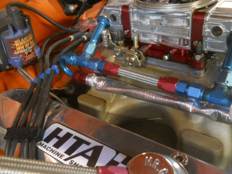

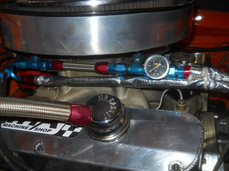

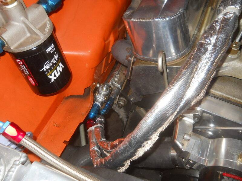

Your problem is the hot ethanol fuel bubbling will not lift the float to close the needle and seat. You need to put a return on the system as they did on all carbureted engines 74 and newer. If your using a mechanical pump use the style in the fist picture. With a electric pump and a holley style carb use a return pressure regulator and the style in the second pictures.
I had the same problem. I would start it with the pump off and turn it on and off until fresh fuel reached the carb. Once I installed the return it fixed the problem. I always install a return on all mechanical pump cars as seen in the first picture. Problem cured.
