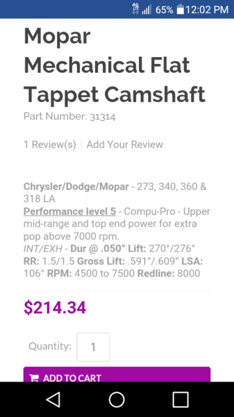

Upgrading to a larger camshaft so I need to install different springs and figured I would upgrade to 10 degree locks also .
I have as supplied all new never used parts on my cyl heads the *** **Retainers are Edelbrock # 9736 retainers 7 degree locks
1.460" Outside diameter of outer spring - 0.755" inside diameter of inner spring .
**** Springs are
Outside diameter 1.460"
Inside diameter 1.060"
Could someone offer a supplier or package # with Springs locks 10 degree & retainers that will directly install on my cyl heads the cam
I want to run has the following specs as pictured thanks Chris
