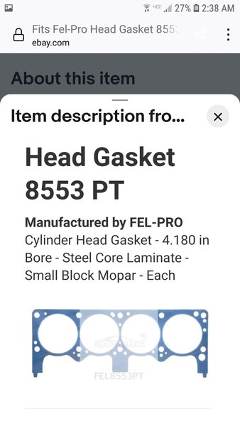

Try the Felpro 8553 PT, Perma-Torque this time around.

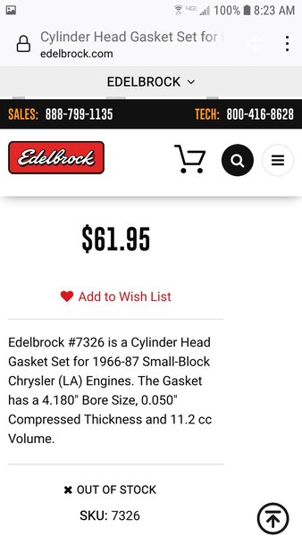

Edelbrock 340 aluminum heads are recommended to use their Edelbrock #7326 head gaskets with a compressed thickness of .050 ths.

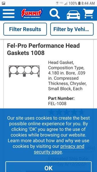

The Felpro 1008 head gaskets have a compressed thickness of .039 ths.
That is .010 ths difference between the 2 head gasket brands bringing the valve to piston clearance .010 ths closer using the felpro 1008 head gaskets.

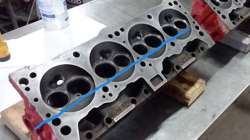

That's just it. They shouldn't. There should be a mile of room. Something's missing somehow. Like the deck clearance of that combo. I'm really curious about that. Although it appears those pistons are the 72/73 style, "WHERE" do they sit at TDC? Without that info, we're all just guessing.
Valve position in the head comparison.

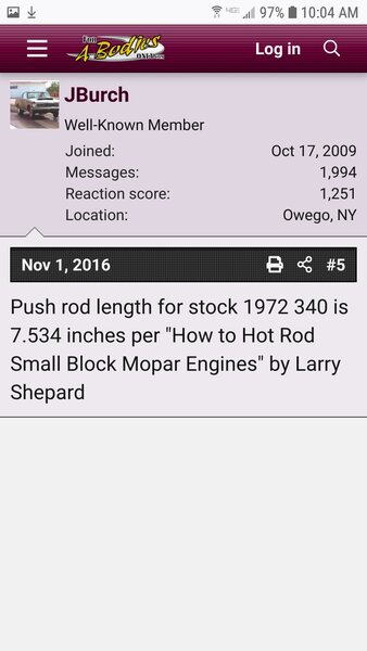

Looks like stock length 340 hydraulic pushrods are 7.5" in length.

This issue is more than likely head gasket related...but then, looking at the crummy condition of the block head surface who knows...? I was expecting to see a fresh, clean engine given that it had just seen a head swap.
Looking at the photos of the pistons, look the brow on top has more of a bevel on one side. Could the previous builder have installed pistons backwards? My old eyesight not the best!

i see the edelbrock head gasket is thicker than the one i used. That could explain it too.

i measured the push rod length and its 7.5. so i am good there. my thinking now is its cam timing and may have been like this prior and the edelrock valves hit again bending valves. not sure how i did not have the over heating problem before. i am going to be incredibly pissed if both heads have bent valves.
