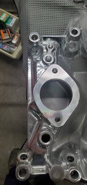

    Does this intake have a proper Magnum thermostat size and position like the Edelbrock 7577 that this thread is about or does it have the LA thermostat size and position?

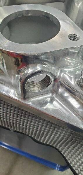

    here are pics on mine that is in the shelf. brand new. to answer a question prev asked, assault brand intake, 20201017_102905.jpeg 20201017_102856.jpeg 20201017_102852.jpeg dual pattern not eddy.

    la style bypass it appears. i was just trying to show what my intake has for heater and sending unit tapped holes on passenger side. sorry if off orig topic/offends anyone.

    I drilled one of the holes out to fit an NPT to AN fitting in it. I did this on my edelbrock and on my current M1 intake.

    Should not offend anyone. Appreciate the photos and update. I was just wondering if that was an intake I was not aware of that did have Magnum thermostat size and position.
