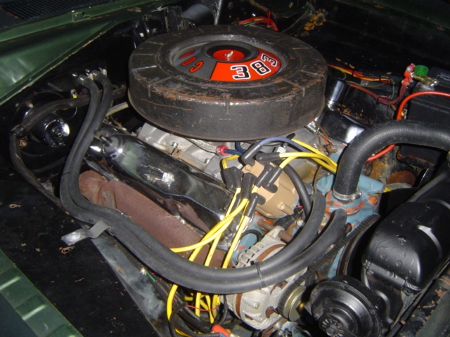

I used a Weiand intake with a Holley 750 and a drop base and the original air cleaner top for a while. I had the aftermarket top on the air cleaner, and one day just tried the original top to see if it fit- same air cleaner element used and no problems.
