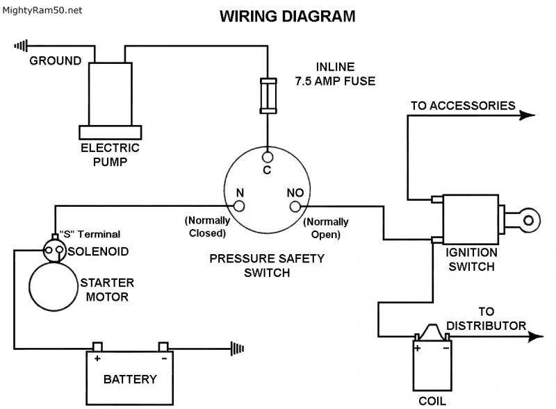

so looking at these pics is the above diagram wrong
when i wire it up as shown in the bottom pic the car cranks as soon as i turn the key on....i dont know why i cant get this lol shouldnt be hard. seems i cant get the two wires on the oil switch right. the hot in run wire, and the hot in crank wire. i thought the hot in run wire was the + wire for the coil off the ballast.and the hot in crank wire was the sol to the starter..
Three terminals, C,N,NO
C goes to fuel pump
N goes to starter solenoid
NO goes to ignition "on" terminal
So, fuel pump gets power during cranking and also when key is on AND oil pressure is over 5 p.s.i. this is what i thought should work,,, as stated in #4 post is this correct?
i have it wired as in post#4 when i turn the key to crank it cranks but when i let up on the key to run it stays cranking...help lol and thanks
I don't know. Your description of C/ NO/ NC should work. The only difference is that you feed C to fire a relay instead of direct to pump. Not trying to talk down to you. C is like the center of a so called "2 way" 3 terminal switch. Whichever way the switch is thrown, one of the outer terminals connects to center which is "C" or "common."
So NO normally open, when there's no oil pressure, that contact goes nowhere
NC when there is no pressure that contact goes to C
So when the start relay fires, that should send power via NC and C off to the pump or pump relay
When the oil pressure comes up, the pressure switch flips, connecting NO to C. Now the power from NO feeds through C and powers the pump or relay, and the NC is now open (with pressure) and it goes nowhere
Only advice I can give you is either disconnect the pressure switch and test it on the car, or pull it off and test with air pressure. Use a test lamp or meter and confirm that it is working as expected. NC to C should be closed with no pressure, and NO to C should be closed with pressure
thanks for the reply, the no on the pressure switch goes to the dark blue wire that is hot when the key is on its the 12v on one side of the ballast correct? and the nc goes to the starter sol on the starter relay.
Yup. When the pressure flips the switch, the NO connects to the C and then the key ignition circuit should keep the pump/ relay powered. I have no ideas on what you did with the "run" problem. Does the problem still exist if you unhook the pump wiring/ relay and just jumper the pump manually?
