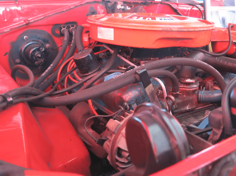

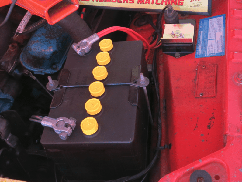

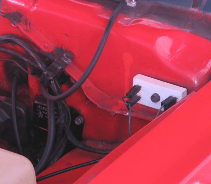

Hope this helps. Harness leaves the bulkhead connector and immediately splits, main components to the left inner fender well but a group of engine wires (ignition, alternator, water, oil) goes to the right. On the left the loom will follow indentation in the fender well, behind the battery and through large hole in radiator support (tried to show in my pics, I see in yours). Now a group of wires drop down for left side lights while the loom follows upper radiator support with retaining clips to the right side that will have connectors for right side lighting. Good luck.

More pics, happy to help. One note of caution- my car is a '68 cuda which means it has points ignition and a mechanical voltage regulator. So some of the details will be different on your car but am helping because they are very similar. Here are some new pics from the bulkhead connector to the radiator support.

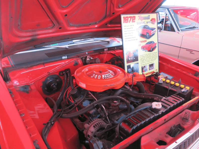

This is the bay of a '72 'survivor car' that was at Carlisle in 2019. Maybe a little closer in some of the details - assuming its routing has not been altered.
The cable going to the front lights has been pulled away from channel it runs in. In the shadow we can see the plastic wire retainer the cable should be taped to.
I'm surprised to see the ballast resistors above the lip. Seems too exposed to rain water there.
This may be a retrofit of a Chrysler ECU onto a car that came with points. :( Sorry

Thank you Murray awesome pictures this will definitely help me to finish this part up
