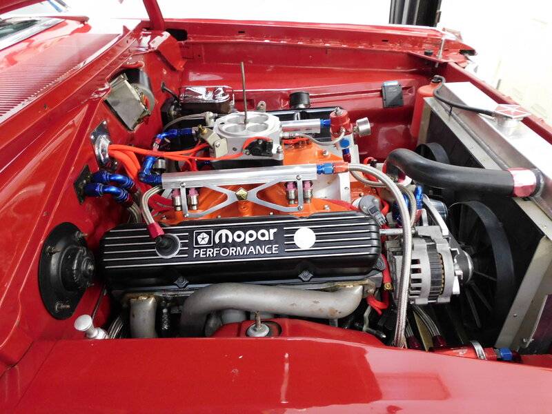

Got it pretty well finished and cleaned up today in preparation for the St. Louis MOPAR Blast show.
Also just installed a set of .92 torsion bars and got the stance leveled out and a little more road clearance and less bounce than the .87 small block bars.

Looks nice and clean in there ! I gotta ask ! What you got going on there with the distributor/ Ignition ?
Most everything You see I have made myself or modified to suit my needs.
That is how the car got the name "Home-Brewed" from the October 2006 MOPAR Action center fold article.
With my last name, the Six Pac hood and the fact I made everything for the EFI before anything was on the market.
It is a 512 cu. in. 440 engine.
I am using a F.A.S.T. XFI 2.0 and F.A.S.T XIM
The trigger wheel is a "Home-Brewed" 36-1 (made by member @wish4hemi ) with magnetic Hall Effect sensor
The Cam Position Sensor is a slightly modified 4.0L Jeep unit.
I also made the wiring harness from the trunk mounted battery to the under dash ECU's to all the points on the engine.
