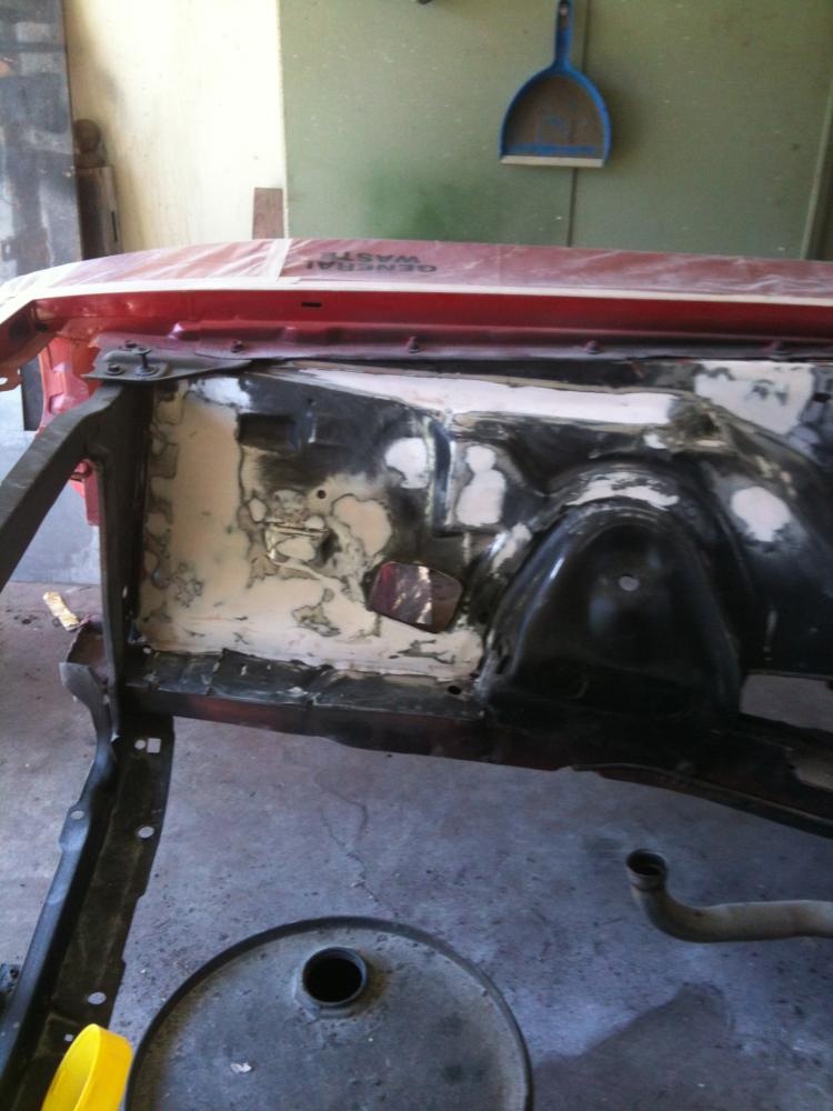

hi guys and girls thought you might like to follow along as i pull my 318 out of my 73 cuda patch and repair/straighten my engine bay for the fitment of my new 451 stroker and also rebuild my front end with all new components
engine out and welding up air con holes plus other holes i no longer need

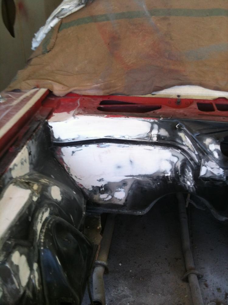

take the whole engine bay back to bare metal and spray with black industrial etch primer,gring back rough sections and fill withh bondo/bog

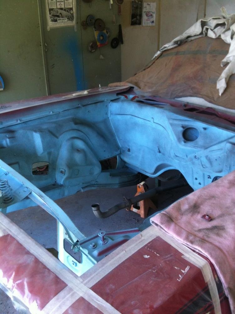

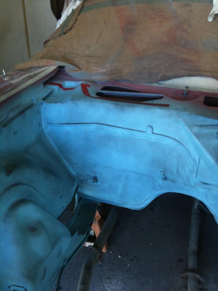

all filler has been sanded ,etch has been scuffed up and now put into putty
lower control arms fully sandblasted,ready for stiffening plates,k frame sandblasted and in etch ,engine bay sanded back after first putty,another decent coat of putty and it should be ready to go,yahooo rally red here i come

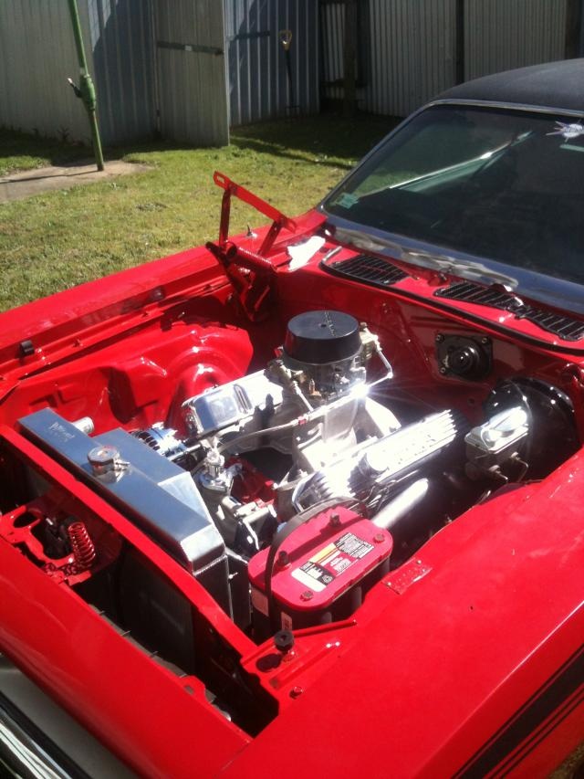

finally got the engine bay painted on my days off,painted it in acrylic base coat with a 2pak clear over it as its what i had laying around,i,m really happy with it,considering how ruff it was:cheers:

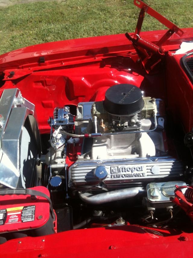

its been a long road but i now have a super clean 451 to go hunting chevys
Dang man!! That looks very nice, Heck!! if you want to race something fast :cheers: race an A body MoPar :D sorry I could not help myself :D Very nicely dun =D>
Nice work! Just hearing the rumble from that 451 will make ricers quiver.
Nice nice nice,but I wander how long will that transmission live with that collector so close heating up the oil.
Looks good! I was worried when I scrolled down and saw that black paint in the engine compartment.
