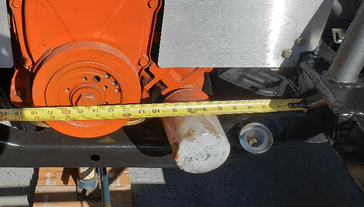

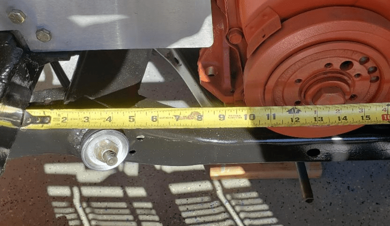

As everyone knows all info on the internet is 100% accurate, but just in case the one piece I am trying to find out thought I would ask and see if someone here knows for sure. My 69 Dart has a 72 360 installed, it had what looks like the solid Moroso mounts in it when I got it and some cheapo headers. I am going back to the rubber biscuit mount and some Dougs headers (not the Blues Brothers one) and engine seems low. TTI gives some dimensions to use but was curious if they are actually valid. centerline from top of K member is noted as 5 1/4, with tolerances I could handle a little off but mine is close to 5/8 - 3/4 off from that, I ordered the truck biscuits which might take care of my queery but is there a true spot I should be looking for or should I just make sure the fan doesn't hit and let it go? my headers hit the torsion bar on the driver side, I have no issue slamming it with a hammer and even after tonight raising or lowering and checking it isn't going to take care of the clearance so there will be wacking.

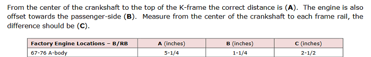

This is big block placement a member was kind enough to send me. Since it is based off crankshaft center line, it should be the same for the small block.
I apologize, Bill. I posted this and then realized yours is a later A body. All of the above information is for an early car.
but the dimensions you have from what looks like TTi will apply, Summit has me covered, will know where I set less than 24, was more curious if the numbers applied, I have spent so much time wading through contradicting info about this car - makes you wonder if people are even looking or working on the same cars

used the thin mounts with a shim, motor is off on the side to side dimension 1/4", little more effort to get the centerline to kmember measurement, I know its off but not going to worry to much about it, the 1/4" would clear me for my headers but don't see a quick easy way to just move the motor over to the passenger side yet
back and forth with several adjustments on mounts angles and anything else, per the "perfect numbers" mine is off, will live with it, the top of kmember to center of crank is off by about 3/4", gonna leave to keep that clearance for my hood and the airgap intake - the offset is 1/4" off, gonna hammer 3 tubes and move on, I felt like I had things pretty close on the side to side, 2 tubes were still barely touching and one tube was clear but no room for the motor to move at all without possibly hitting, 3 dents is a small effort, no one will even know unless I run over them and the see before they die LOL
