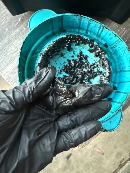

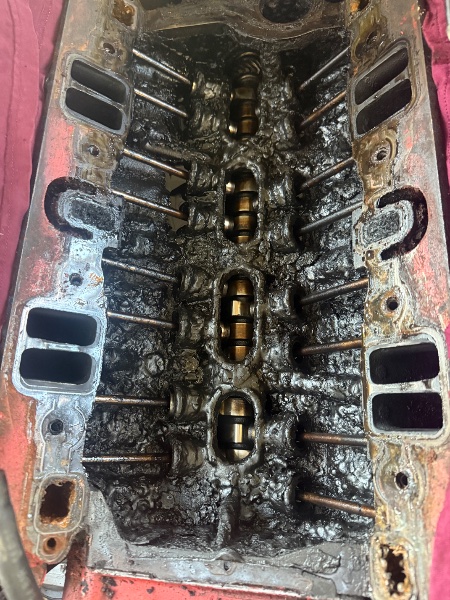

In the 2nd pic, it kind of looks like a chunk is broken out of the edge of the piston. Of course, I've never been good at identifying ink blot pics either!
Ink blots and magic 8 balls…neither playing nicely with me. I wasn’t able to tell, tried to get a poke and the black oil globs were hardened. Definitely could be coming out from piston damage, no idea.
Hard to tell and eventually ran out of time to experiment. I’m sure I’ll go back and look at some point while I’m waiting to get it back on the road
I've never seen Pennzoil do that, Quaker State, yes, but having said. I worked at an automotive machine shop for awhile when I was 21, we called them Valvoline engines. Some of us forget that we used to have non detergent oil. I have seen carbon build up like that and carbon wax build up like that. I certainly wouldn't waste my time trying to clean that up, it wouldn't even cross my mind. I would overhaul it, not 318 it.
I haven't forgotten. I still use non detergent oil. So should anyone who runs a flat tappet camshaft. Either low or non detergent.
Is the engine back running? If so, run it at high idle and revving it higher and slowly dribble a bottle of water through the carburetor. That will break up those carbon chunks in that cylinder. You can also use seafoam. It will smoke the neighborhood out but that will probably fix it.
Looks like build up broken of the intake valves. I bought a 360 and when I opened it up the intake valves looked like tulips, they had so much build up on them.
It runs pretty decent, if it didn’t cost me 15 dollars in disappearing oil every time I drive it it’s probably be fine as is. I’ll give that a shot today and take another look. Couldnt hurt at this point.
Already smoking out the neighborhood and anyone driving behind me half the time.
Obviously your valve seals are nonexistent. You could install new Viton positive valve seals. You could also bring the piston to TDC and get a drill bit the Minor diameter just a smidge smaller to fit through the spark plug threaded hole. Then turn by hand just enough to break up that carbon lump. Clean with a shop vac to get as much carbon out of the cylinder as you can. Run Valvoline 20w50 racing oil with a good filter. What intake manifold gaskets are you running? This also could be an exercise in futility, but it would be a last ditch attempt to keep it running while you line up a replacement.
My brother had a 340 that was sucking oil out of the lifter valley at the bottoms of the intake ports due to bad seal of the intake gaskets after an intake swap. We always put some silicone sealer around the gaskets at the bottom of the intake ports on all intake installs after that, just in case.
