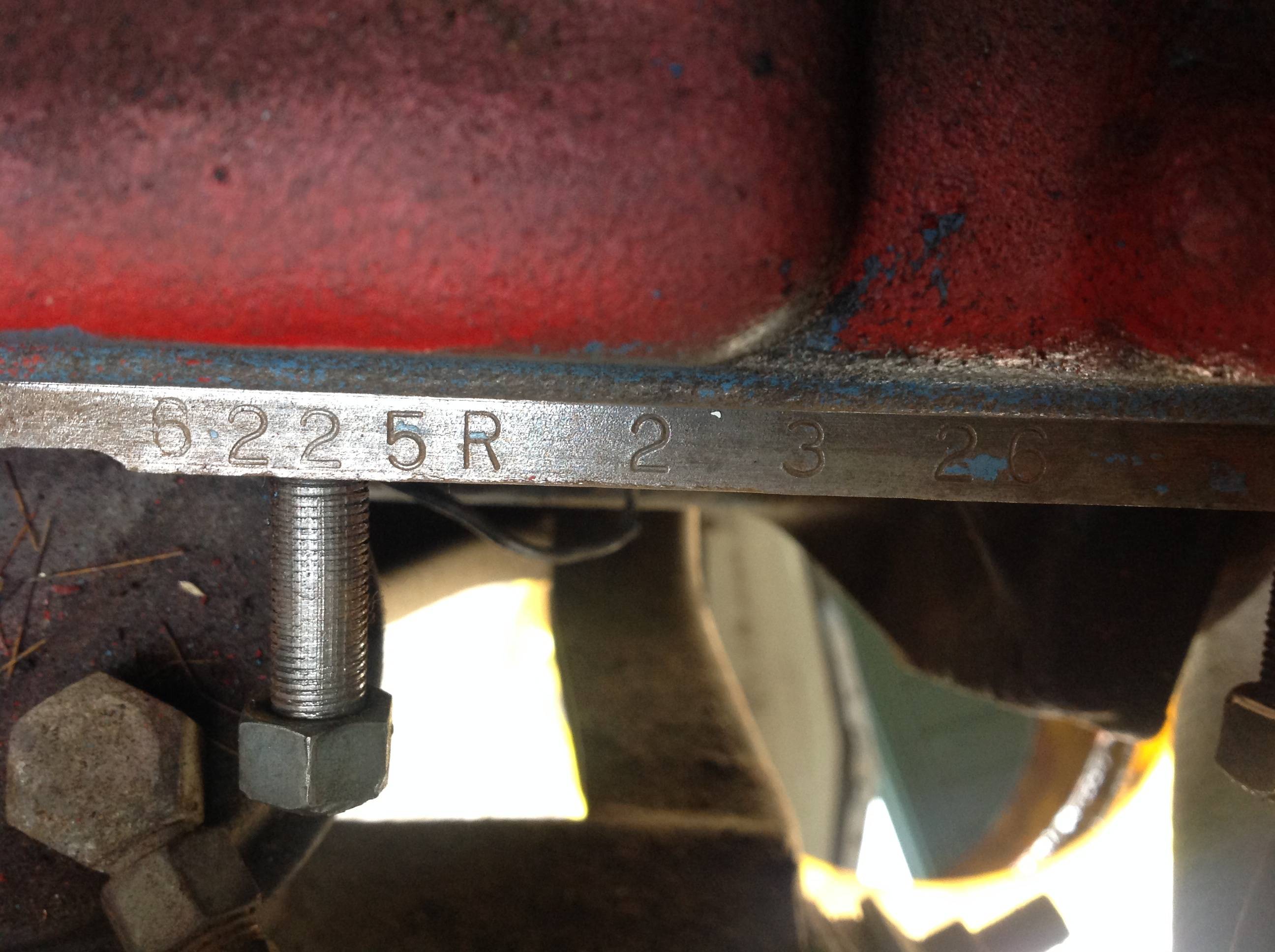

My first question is regarding the engine serial number. The guy I bought the car from said it originally had a 170 cid, but was replaced with a 225 cid. I don't know where, when, or from what this second engine came. There was no air cleaner at all..he said it was stolen. I've poured through endless posts and search pages trying to find a definitive reference for deciphering the serial number code. It's a bit confusing. The serial number is 6225 R 2326. From what I've read, I'm sure it's a 225. I'm thinking it might be a 1976 engine, but the date code at the end makes no sense to me.

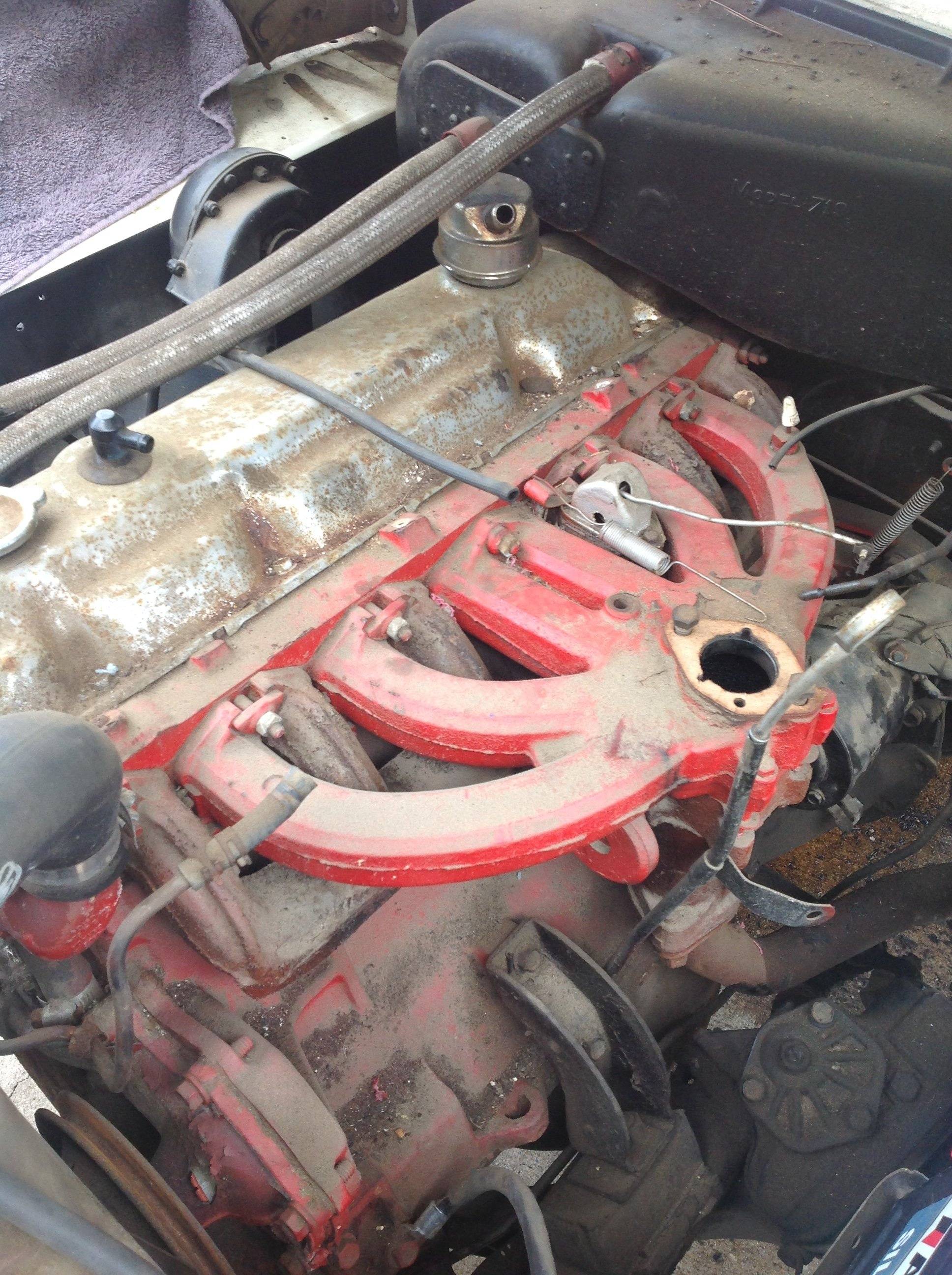

The other issue that has me baffled is the crankcase ventilation system. I'll assume I need a breather with a hose connection to go to the crankcase breather inlet. I see the vent line from the fuel line which returns to the carb. As I understand it, the hose from the PCV valve should return air to the intake manifold. I see no provision at all on the manifold or the carb for such a hose. Would it have gone back into the air breather to be filtered before being sucked back down the carb? I would think that the wet oily air would gum up the air filter and the carb. Would an engine from 1962 even have a PCV return system, or would the hose just trail under the frame as an OCV system?

What is the casting date on the block?
One hose connects the PCV valve in the front part of the valve cover to intake manifold vacuum. There is usually a large nipple on the carburetor throttle plate for this. This sucks oil/fumes into the intake manifold to be burned. The breather at the rear of the valve cover gets connected to a hose which draws clean air from inside the air cleaner.
No, it's 6225 R 2 3 26. The spacing matters.
6: 1976-model engine.
225: Displacement
R: Regular-fuel/Passenger car engine
2 3 26: Fun with inconsistent date and line codes. Could mean the 26th engine assembled on February 3, 1976. Could mean line № 2, engine built on March 26th.
Of note, there is no "E" in your engine's stamping. That means it was made before the change to cast crankshafts in Slant-6 engines, which happened before the end of 1976-model production.
First, use the right words. The breather is on your valve cover. The air cleaner sits atop the carburetor. You don't actually need an air cleaner with a fitting for a hose to run to the breather. You can leave the breather's port open to the atmosphere -- that's how it was done originally on your '62, and on all engines until '64 (California) '68 (50-state/Canada). However, if you wish to duct the crankcase breather to the air cleaner, and you're running a 1-barrel carburetor and want an original-looking air cleaner, then the one to seek is a '64-'69 item, 11" diameter, no snorkel, and with the breather hose nipple.
The valve cover on your engine is a '70-'80 item, apparently chromed. That's fine. Whether or not you duct the breather to the air cleaner, the PCV valve gets a hose that runs to your carburetor's PCV port.

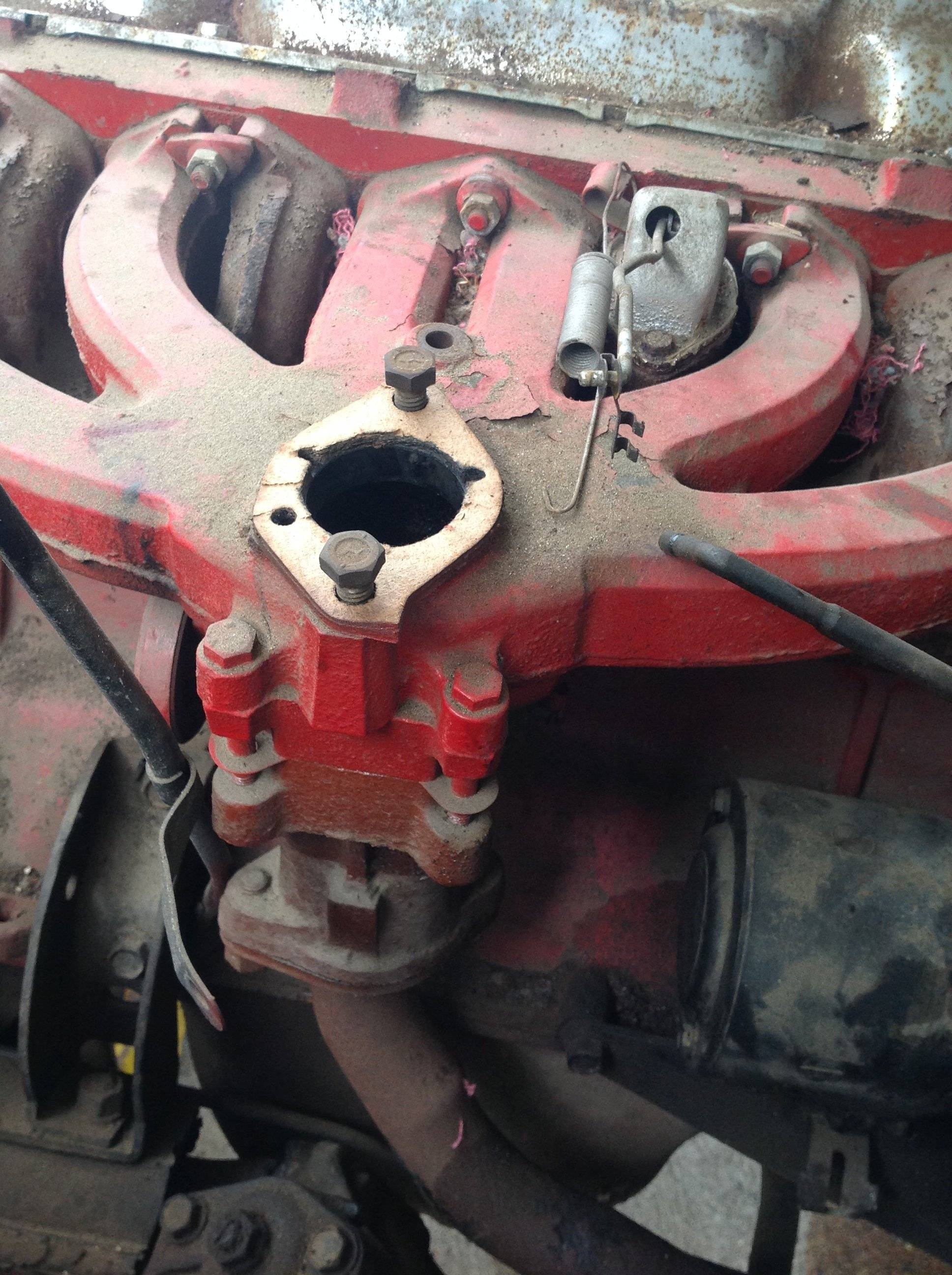

There should be no such connection. In your engine bay I see only the lines that were meant to be there: the fuel line from the fuel pump (upgrade this with the Fuel line mod), the PCV valve just discussed, the vacuum advance hose that will connect the carburetor to the distributor, and the vacuum feed for the heater/defogger, which attaches to a vacuum nipple screwed into the rearmost intake manifold runner.

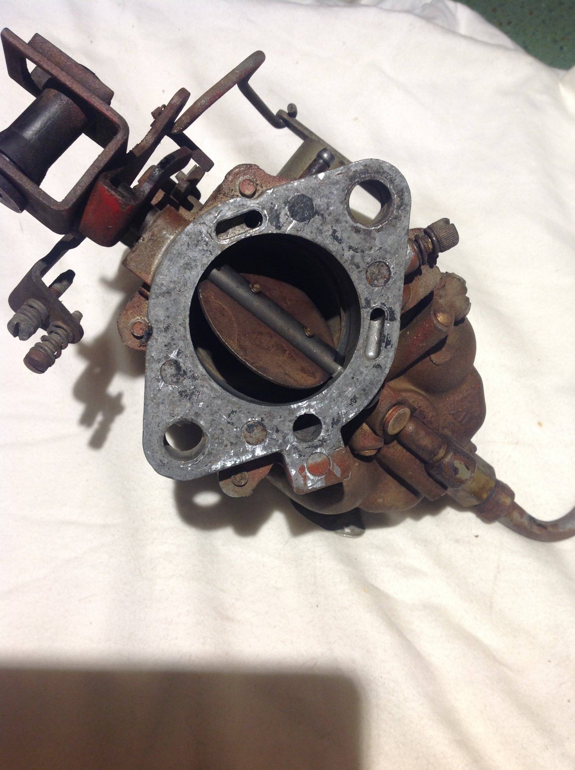

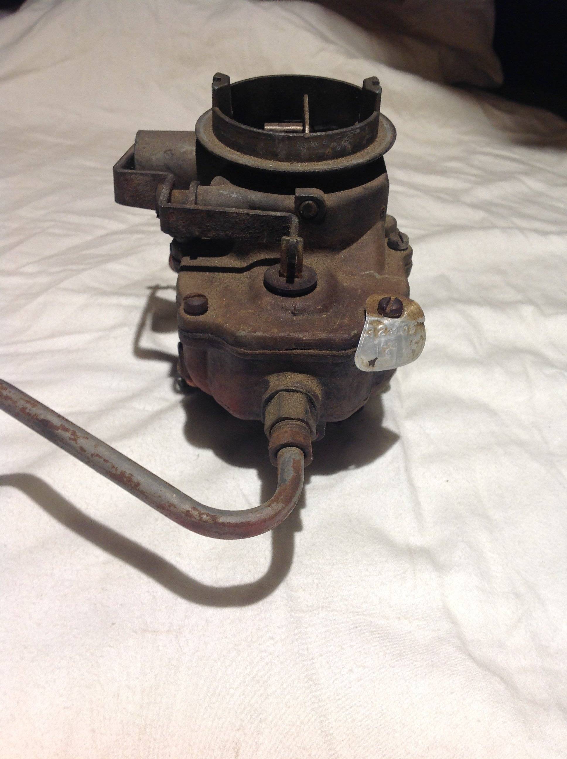

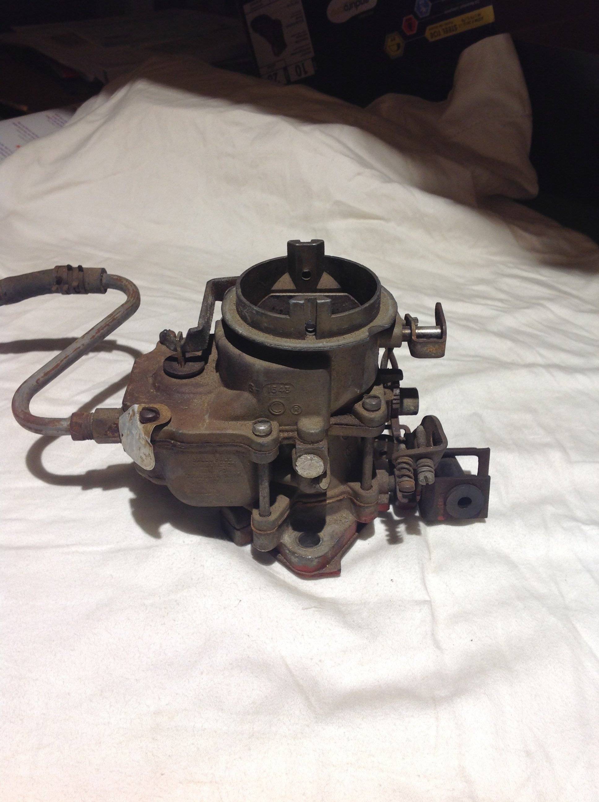

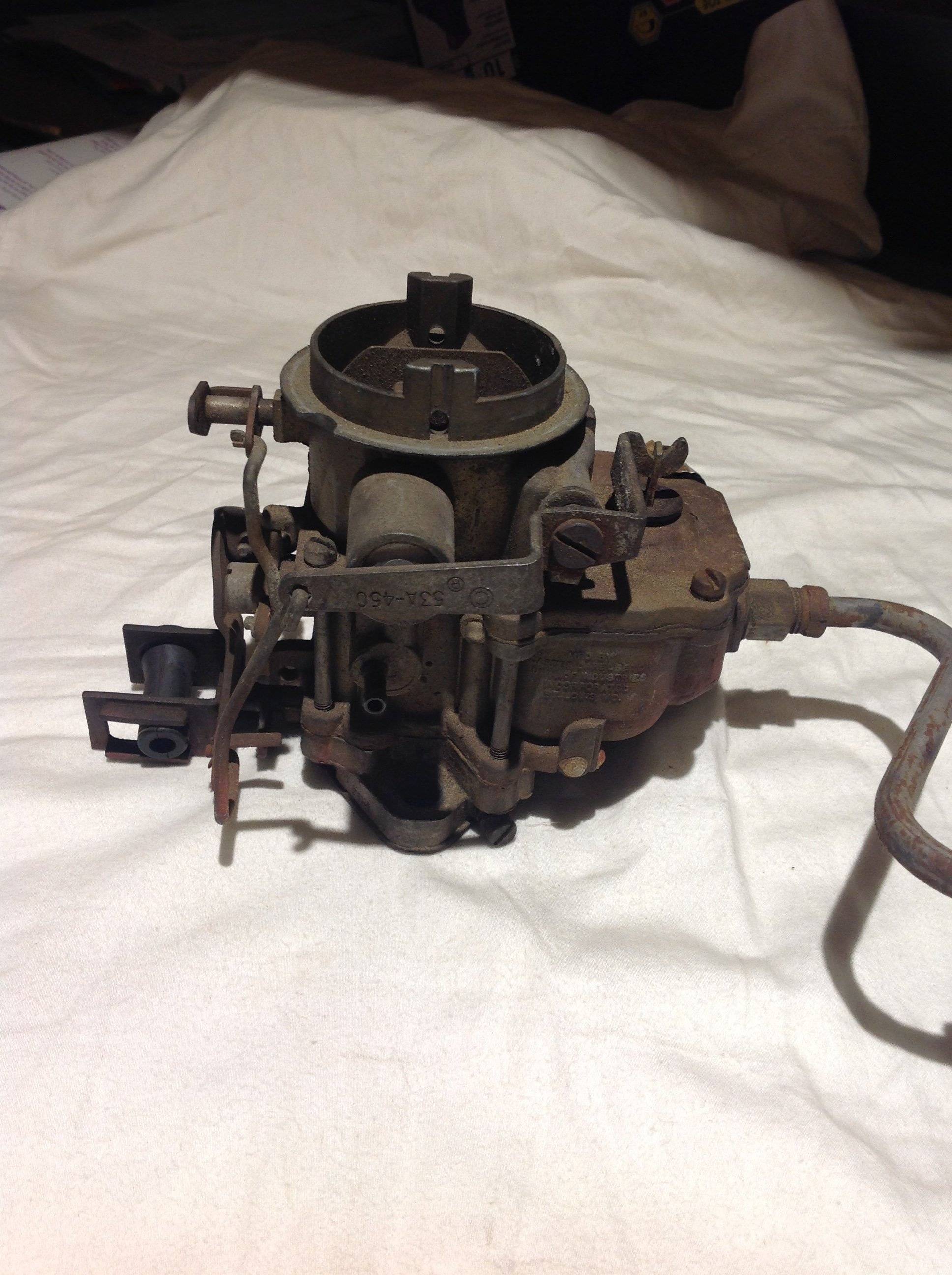

Here's the carb that I took off the engine.
It had no air cleaner and was not attached to the PCV valve in any way. Do you think that although the engine in the car is different than the original (1976 vs 1962) and larger (225 vs 170), that this might be the original carb from the 1962 170 cid? That carb wouldn't have had a PCV port right? Should I be looking for a carb that is appropriate for the 1976 engine and the newer emissions feature? A newer single barrel carb would have the port I need...correct?
These are images of a carburetor configured for use on a car without PCV. It is a Carter BBS 3287s or 3237s (I can't see the stamping on that little silver aluminum tag clearly enough to tell which). Probably 3287s, which was original equipment on 1962 A-bodies with 170 engine equipped for fleet service (not quite as small and lean as taxi-spec carbs, but close). The 3237s was original equipment on 1962 A-bodies with 225 engine and stick shift. Either of these carbs bolts right onto any Slant-6 1bbl intake manifold, and any Slant-6 manifold goes onto any Slant-6 engine, so it's not surprising to have found this carb on the later engine. The difficult bit is that these cars (Slant-6 A-bodies through '66, except '65-'66 with factory A/C) have a rotating-rod throttle linkage that requires a carburetor with the throttle lever configured as shown in these pictures: a U-shaped bracket holding a rubber bushing that accepts the hooked end of the rotating rod. Starting in '67 ('65 on factory A/C cars) a cable-type throttle linkage was used, which requires a different type of carburetor throttle lever. Some carbs have throttle levers configured to accept both, but even those are growing difficult to find.
The 3287s is, as I say, a small carburetor set up for fuel economy. It'll run a 225; I had one on my '65 for awhile a couple decades ago. That car had PCV, and I modified the carb to accept it. This required carefully drilling two holes in exactly the right places. It worked fine.
As for what you should do: that depends on your goals for this build. Are you wanting to stick with a 1bbl carburetor? Go to a 2bbl? Something else?
The number on the tag is 3230S. Ultimately, I'll probably end up replacing the intake and exhaust with
Number on the tag is 3230S....not easy to read in person either. Ultimately, I'll rebuild the engine and replace the intake/exhaust with some of Jack Clifford's spicy stuff. For now, I've got a few other unrelated projects going on and would just drive this car around for awhile before official disassembly and restoration. How hard do you think it would be to find a 2 barrel that would accept the rotating rod style throttle linkage?
1962 170/automatic, non-taxi, non-fleet, without PCV. Not quite as lean as fleet, but still small.

interested in modifying this little one barrel to accept the PCV connection, fire it up, and call it a day. Do you think you could guide me through that? I'm a dentist by trade, so careful detailed work is kinda my thing.
Well, then yeah, you'll have no trouble with precision drilling! Compared to toothwork, this'll be a cinch. Here's what to do:
Fetch one of these. Neatly cut off the flare—just the flare, taking away only minimal tube (a little tubing cutter is best, but do what you must) and remove the flare nut. Now you have a nice little elbow with a hose retention bulge at one end.
Obtain a correct carburetor base gasket. You will note there's a 1/4" hole in it adjacent to the outboard carb mounting bolt hole, next to the throttle bore. You'll find a matching 1/4" hole in the carb mounting pad on the intake manifold. Temporarily attach the gasket in its correct orientation to the bottom of the throttle body. There will be solid aluminum (throttle body) visible through that 1/4" hole. You will be drilling here.
Look at the left front corner of the throttle body, facing just about exactly the same direction as that aluminum carb ID tag. You'll find an arch-shaped boss. You will be drilling that boss to accept the straight (no bulge) end of the elbow, aiming for a fit that can readily be sealed with a smear of JB Weld or similar on the shank of the elbow before its insertion.
The trick here is to make these two new holes intersect neatly, without leaving an obstruction, and (this is the don't-or-die part) without breaking through into the throttle bore or the top surface of the throttle body.
Clean out the chips thoroughly—this shouldn't be an issue as you'll surely be cleaning and rebuilding the entire carburetor since you've already taken it off and apart. Install the elbow so it exits the throttle body and makes a turn toward the passenger side of the car.
Once the JB-Weld has cured, install the cleaned and built-up carb. Use oilproof hose (crankcase vent hose or fuel line hose) to connect the PCV valve to the new fitting on the carburetor. Use a hose clamp if necessary for secure retention.

Thanks again for your guidance. I immediately grabbed the carb to verify the landmarks and lo and behold, there is already a blind hole in the throttle body from the bottom in that location. Just a connecting lateral hole and we're in business. Certainly much easier than new carb/manifold and throttle linkage swap....
Thanks for the fuel line mod tip too. That makes a lot of sense to me.
Sweet! That makes the retrofit much easier.
