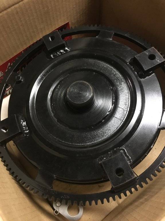

Here is the converter in question:

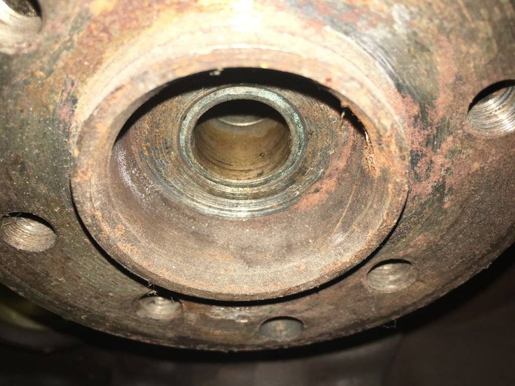

And here is the crank in question. Yes, it’s drilled for a pilot bearing as the motor came out of a 4 speed 66 Barracuda
How much of a difference is there, crank looks pretty rusty take some sandpaper to it and then measure it with a caliper if you have one.
Although it appears the motor might be on the floor, it’s still on the stand. My camera focuses pretty good for getting a closeup between the part holding the motor and the motor. If I take it off the stand I could get a better idea and easy to measure.
I was able to get a Caliper into the crank pocket and came up with 1.70 inches in diameter. The converter snout measures 1.80 inches. I’ll have to see what Dynamic says when they reopen Monday.

With the dimension you listed on crank I would clean it out really good and remeasure it.

To bring closure to this thread I called Dynamic this morning and talked to the main tech - Sean Wiley I believe was his name. He did not recommend turning the nose hub as it would make it too thin and cause problems with the bushing that's inside the nose. As I suspected, his recommendation was to pull the crank and let the machine shop enlarge the pocket. He then brought up another point based on the converter - by the part number it was built and assembled to go behind a mildly modified 340 and I would be less than pleased with it's performance behind a stock 273/235 Commando motor. His recommendation was if I did the crank would be to send the converter back and they would rework it to use behind the 273. So I have these options to think about as well as go with a 4 speed since the crank already has the bushing or go with a 5 speed T5, Dakota or Colorado 5 speed conversion as detailed in another thread.
I would take a metal removal tool to the inside of the crank area and then remeasure. no way would removing a maximum of .050" radially make the hub too thin . a good machinist could do that in 25 minutes. how much $$$ for another unit, I would try the 1 u have. reread lkopasta post
