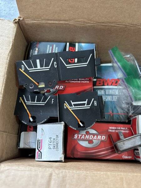

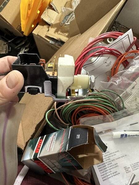

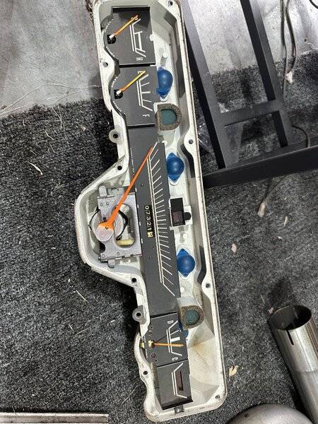

I’m getting a headache just thinking about this stuff and my ADHD is going haywire… came out to look at the dash and clean on the bezels… then broke this little doohickey that is for the alternator gauge when I was trying to get at the melted bubble. So I thought let’s look and see if I have a new one, I know I remember seeing some in a box. That led me to grabbing the wiring stuff….
But yes all the American auto wires are labeled nicely. In the kit. The old owner even left me secret messages….

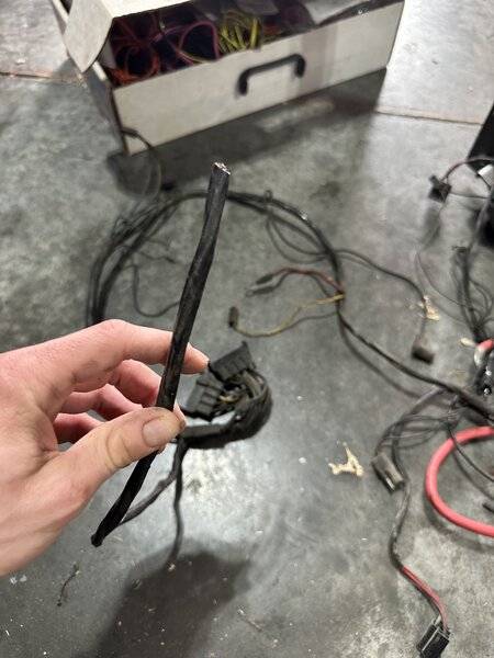

The way I understand this, the OP DOES NOT HAVE all the factory stock harness(s). THAT is a problem, because without it all, you won't have the factory CONNECTORS you need. Most those connectors, you can obtain the terminals as long as the plastic SHELL is OK. But, you do have to HAVE them, first.
So beat up on whoever is supposed to be getting you the factory stuff and make sure he gets it to you.
If you decide to buy an "as factory" repop harness, you will likely have what you need. but you certainly cannot make use of the Painless harness otherwise
AMMETER you broke/ is broken:
Are ridiculously simple. They are a magnetic needle movement and the brass shunt across the terminals, which generates a field to deflect. You need to be sober, alert, and pretend to be a jeweler. The needle should be centered when not in use. If you simply damaged the delicate rivets on the one gauge, you may be able to find some tiny screws and nuts, like 2-56, etc. Or even JB weld. There are some photos here and there, of guys who have repaired them.

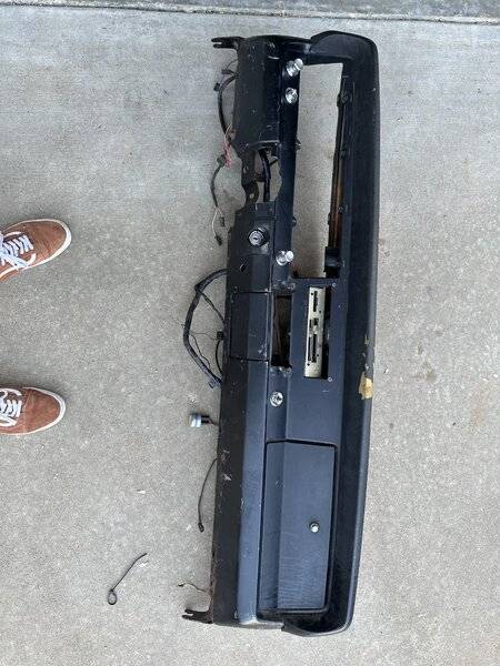

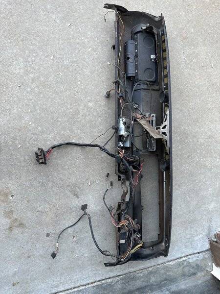

Well got to talking and I got a stock swinger dash harness… been sitting in his shop since 87. Came with the dash, little knobs, and other things that I need. only going to use the harness and glove box door for now.
I still need the heater with ac unit for the dash. He may have it. I’m also getting a heater box with ac and vents from his friend this weekend.
Guy says he has a 7 darts and a bunch of dart parts. Been collecting since like 86 apparently.

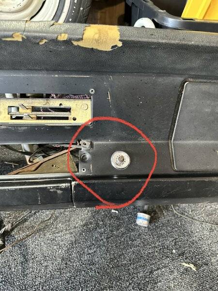

Anyone know what the knob is for on the right of the radio? (Circled in red) Apparently this was a 4 speed dash because it has the spot for the reverse light?

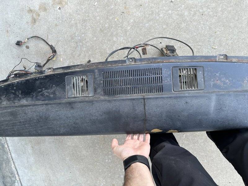

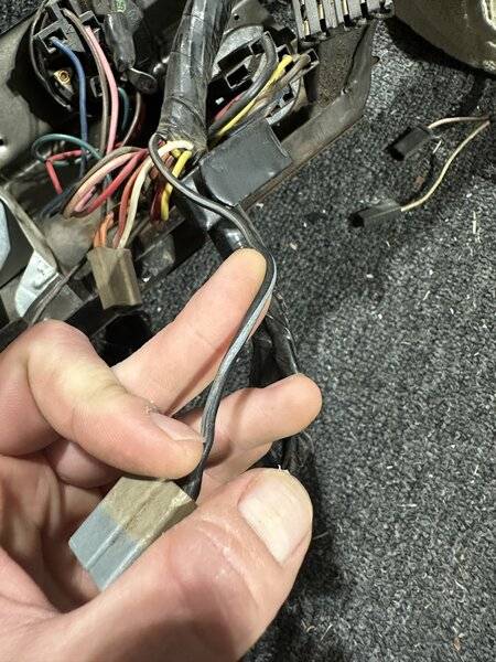

What's the switch number?
What do you mean switch number? It looks like green and black wires coming out of the turn button, then it’s cut. I found another green and black wire then that splits with a light blue or white and black wire that looks like it goes into the dash lights turn switch.

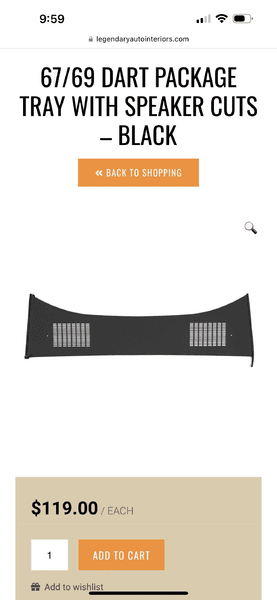

@4spdragtop i figured it out, well asked the guy who I got it from.
He said it’s a rare 69 only option? Rear speaker fader control? I’ll start a new thread and ask where the heck the speaker goes.
Edit- maybe it was a 67-9 option because legendary sells a package tray with the cutouts.
Cool! In the last pic post 35 where its circled, it looks like there is a switch(or something) installed. I figured if theres a part# on "it", that would tell you.
Yep fader was my next guess. :thumbsup:
