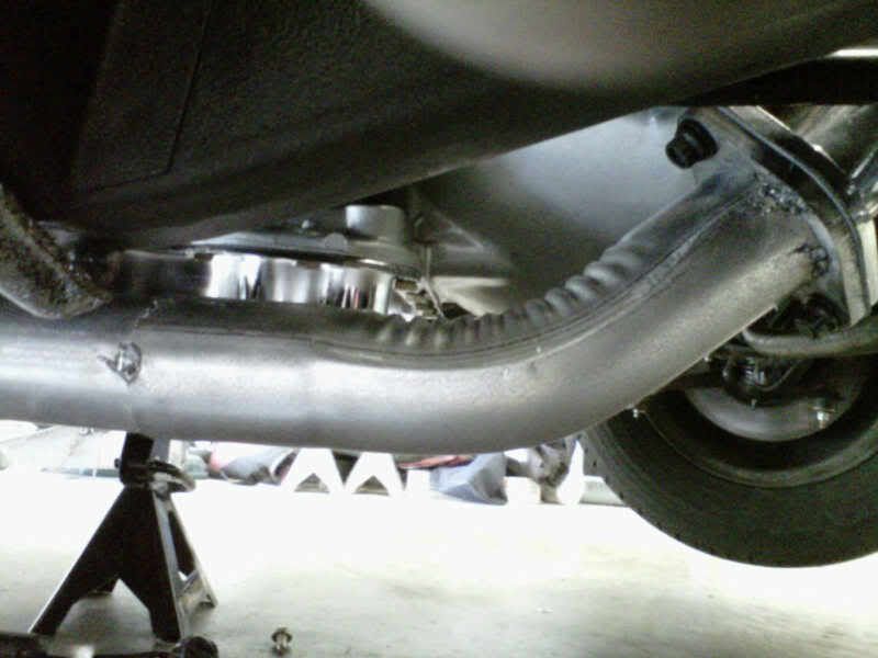

I had a small block 340 in my car before with TTI's small block headers and 2 1/2 inch "X" pipe setup from them also....the Shumacher's presented a problem with hooking them up to the same exhaust....here is what I did and you will probably have to do to..whether or not you do it yourself or a muffler shop does it for you....8)
I had a muffler shop bend a 35 degree for the driver's side and I welded it....
I found a 45 degree elbow and one straight piece at auto parts store for passenger side...
This it what I did until I can get it to a muffler shop and have them make it one piece....any kit you get you will have to do something like what I had to do..8)
I went to my local Muffler Shop here in Huntington Beach to have them connect my Schumacher Tri-Ys to an exhaust system...
