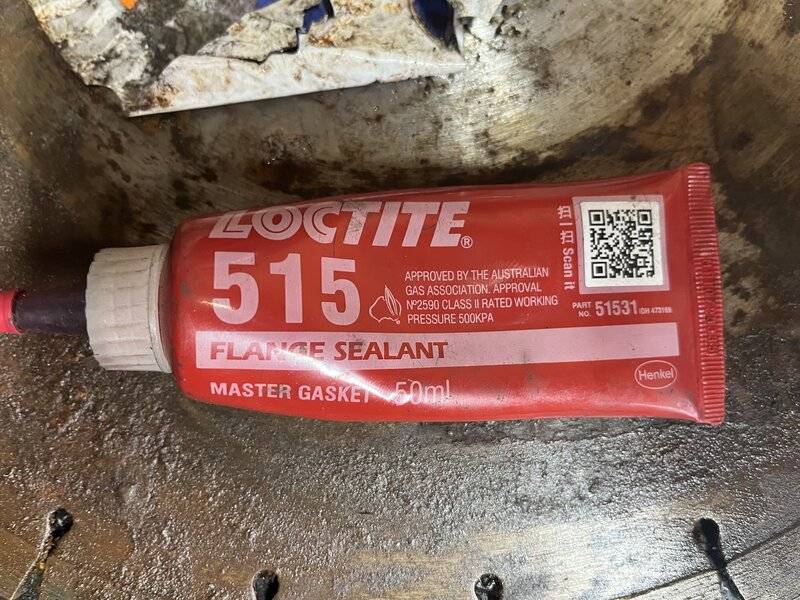

this is what i have used for thread sealant. AND the head where the stud is should not get particularly hot. lots of cast iron and a water jacket to dissipate heat
