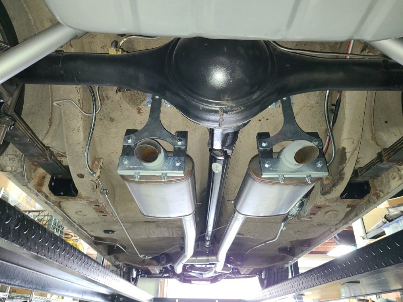

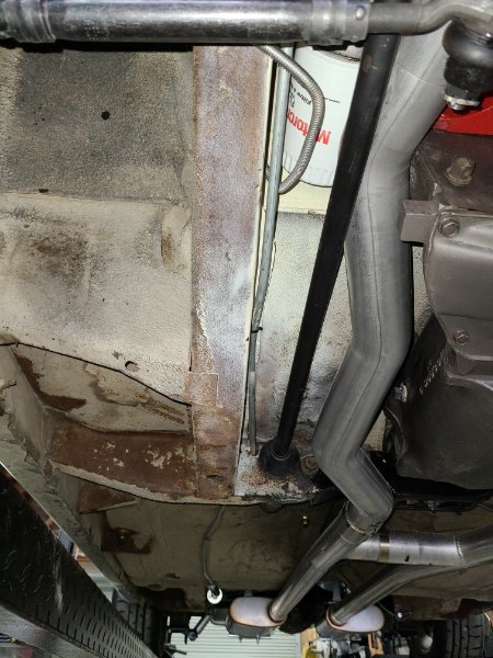

First of all thank you to everyone who replied with comments, suggestions, and especially pictures, they are very helpful.
Here is the update on my install of the TTI system in my Dart and I still have to say that I'm dissapointed in the fit. The biggest problem I have is that if this was a bargain setup, I would understand if things didn't fit quite right and needed to be modified. But for the price paid, I feel it needs way too many modifications to fit the car. I understand cars back there were not built to the same standards but still.
So, on to the update for those of you that are interested. I have since managed to install the driver side of the system and for the most part things lined up but I am still going to need to cut and modify the connector pipe between the exhaust and the header as it doesn't sit flush against the header collector flange. This could be do the transmission change and engine trans alignment so keep that in mind as this may be unique to my setup. I would also prefer that the turn down tip was tucked under the valence instead of sticking out past it maybe this is where the stock tip was so I guess I'll go with it. The passenger side is another story. The tail pipe hits both the gas tank and gas tank mounting strap/hook so I am unable to get the pipe to rotate to the correct position. This mean the angle cut tip ends up sitting at about a 30 degree angle and obviously I don't want the exhaust pipe resting agains the gas tank. The tip alignment may not be a big deal to some but when the passenger and driver side tips don't match it drives me nuts. Now I need to figure out how to make some clearance to the gas tank and fix the tip problem. I haven't had time to figure out how to make some clearance to my fuel tank but it may involve modifying my nice new tank, or cutting and extending the tail pipe section which is supposed to fit around the tank. Extending the pipe around the tank will change the alignment to the muffler and mid pipe, or extend the tip out further which also means cutting and re-welding the rear mounting tab back on and cutting and rewelding the tip in the correct position. On the tip, my options now are to either cut the tip off and re-weld it straight or cut both tips off and put exhaust tips on both sides. Again, in a system that costs this much I feel like I shouldn't have to do all of these modifications. The mid pipe is tight but should work okay but again I'm going to need to modify the connecting pipe to the header.
I have also measured my original tank and compared it with the new replacement and the dimensions are spot on.

Purchased both the TTI long tube headers and dual exhaust for my 1965 Dodge dart original 273 GT car. It now has a 360 magnum with 4 speed overdrive automatic trans. According to the measurements in the TTI instructions my motor is in the correct spot.
Going into this I figured the headers might be tight on the trans but would make the necessary modifications if necessary. Unfortunately, in addition to being tight to the trans it also hits the torsion bar on the passenger side so much that it is off about 1" to the right. I guess I'm going to get to heat and beat my brand new $1000 headers which makes me upset, just glad I didn't get them ceramic coated. Thankfully drive side fit just fine.
Now I'm having trouble with the dual exhaust as well. If I mount the headers connector pipe to the driver side header and slide on the mid pipe and muffler, the muffler hits the differential yoke. If I turn the connector pipe where it bolts to the header it will point about 3' under the car. WTF am I doing wrong here.
I've been building cars for 20 years and have built complete exhaust systems from scratch. This time I figured I would save some time and spend the money on something that just fits. Guess I was wrong, and I now think it is the most over priced piece of crap that I've ever purchased. Will definitely not be buying from TTI again in the future. I now need to cut it all apart and weld it back up so it actually fits correctly. About the only thing that might fit, is the tail pipes but even those have no clear directions on where to mount the tail pipe hanger and the muffler bracket. The directions really suck also. The instructions say to mount the muffler hanger brackets to the body panel behind the rear seat. Does that mean I have to cut a hole in the floor pass the muffler bracket through to bolt it up on the inside of the car? Maybe I'm over thinking it at this point due to my frustrations but what the heck.
Sorry for the long post I needed to vent after this one. If someone has any tips on installing this piece of crap please let me know before I cut it all apart.
