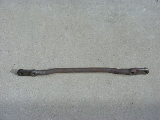

I made a rookie mistake :banghead: while upgrading to 73 up suspension, and did not acquire a 73 up center link, so I have a new style pitman and idler, but I cannot finish the front end until I find the "straight" style steering link to use them with.

Hi Guys, it has been a little nuts at work, so not much to update- but I met member highflyer who set me up with the missing link for the front suspension.
