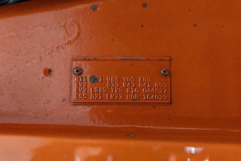

Hi all. New member here from Maine. I recently purchased a 70 Dart Swinger 340. 4 speed car in very nice shape. I’ve been working on decoding the fender tag ( with lots of help researching posts here) and have a particular option code that I can’t locate. It is B10. Doesn’t seem to show up with any identification, but it’s very clear on the tag. Car has the bench seat and rallye dash , if that helps. I see that B11 is for front disc and 11 inch rear drums. Maybe brake related?? All other codes make sense and tie to the car. Appreciate any help you can offer. It’s a Windsor car, USA spec also. Thanks!
It's not an option code I don't think. It's the build Date.....Maybe September 10th of 1969

Post a picture of it
Pic of fender tag
The build date, ok.
But why did Chrysler use sometimes a letter, and sometimes a number..?
Here it's B10, and on my fender tag it's 919 for Sept.19th
Thanks all. That makes sense as the door sticker shows build date of Nov 1969. Code refines to Nov 10, 1969. Now the car has an official birthday! Good excuse to pull out the parts catalog. Thanks again
