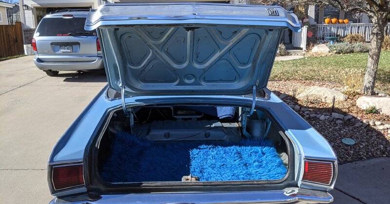

Well tomarrow, weather permitting, I'm off to the welder to get my trunk hinge supports on my 67 Dart Convertible repaired.
In the process I took the trunk lid off and took the hinges off. (Discovered you have to remove 2 screws from the tack strip as they trap the hinge on its post)
Well 53 years of opening and closing has taken its toll on the hinge.
My plan is to have some thin wall tubing welded in the hole to create a reinforced pivot point instead of the thin sheet metal hole.
I found two spacers at ACE hardware, one is solid and fits like a glove. The other is a split type and is significantly looser, but not too loose.
I'll update which spacer worked the best.
I have used tubing to do similar repairs & reinforcing. Nice work!
I know the reason is cost savings but really even if they had pressed a sleeve in the hinge that would have provided MANY more years of service.
My only dilemma is do I go with great fit or loose fit?
All welded up. She went to great lengths to protect the rest of the car.
She even found a support bracket that was never spot welded to the deck and tacked it up. She is going to weld up the hinges themselves later. Went with the great fit.
Painted and ready to install.
Used the silver solid spacers. They fit so we'll. (Bought at ACE Hardware, 1/2" I'd)
