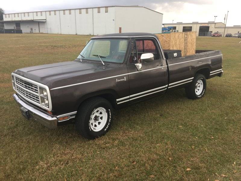

Finally got an old pickup truck!
Wanna do a swap to a 93 D350 chassis with this one... no rush though.
