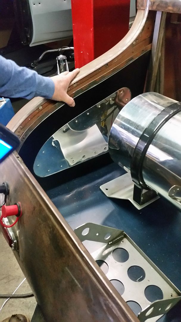

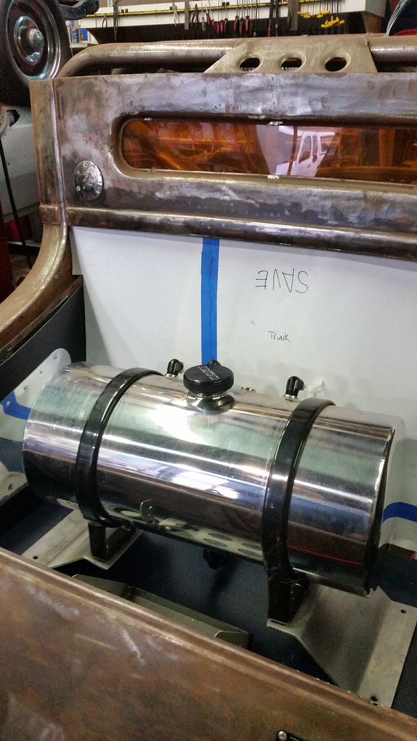

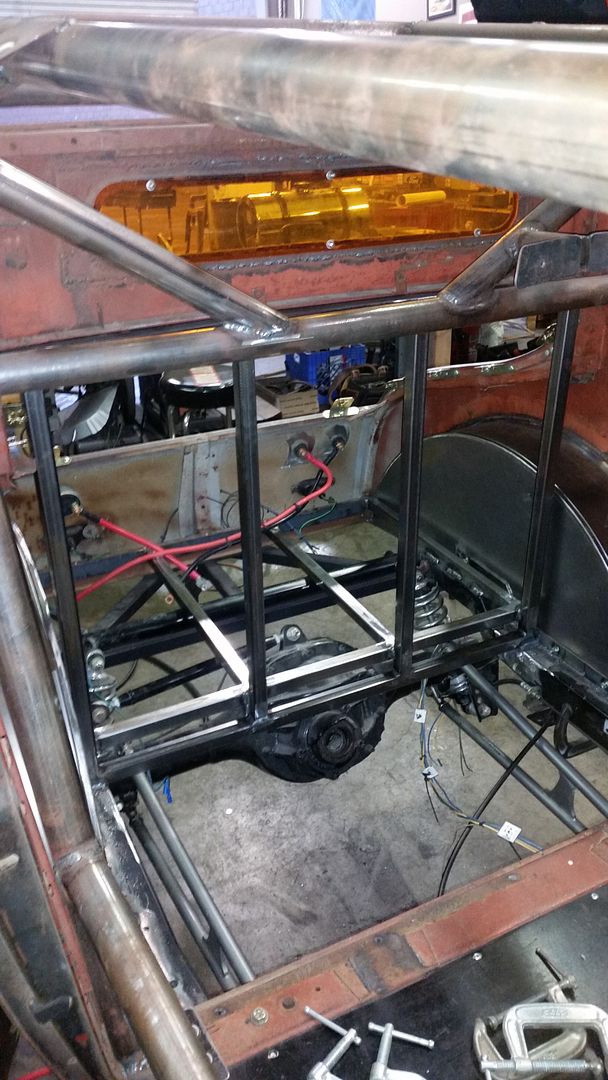

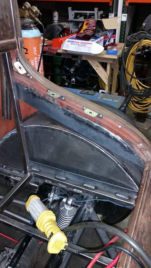

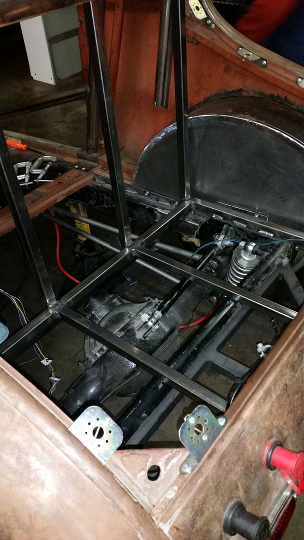

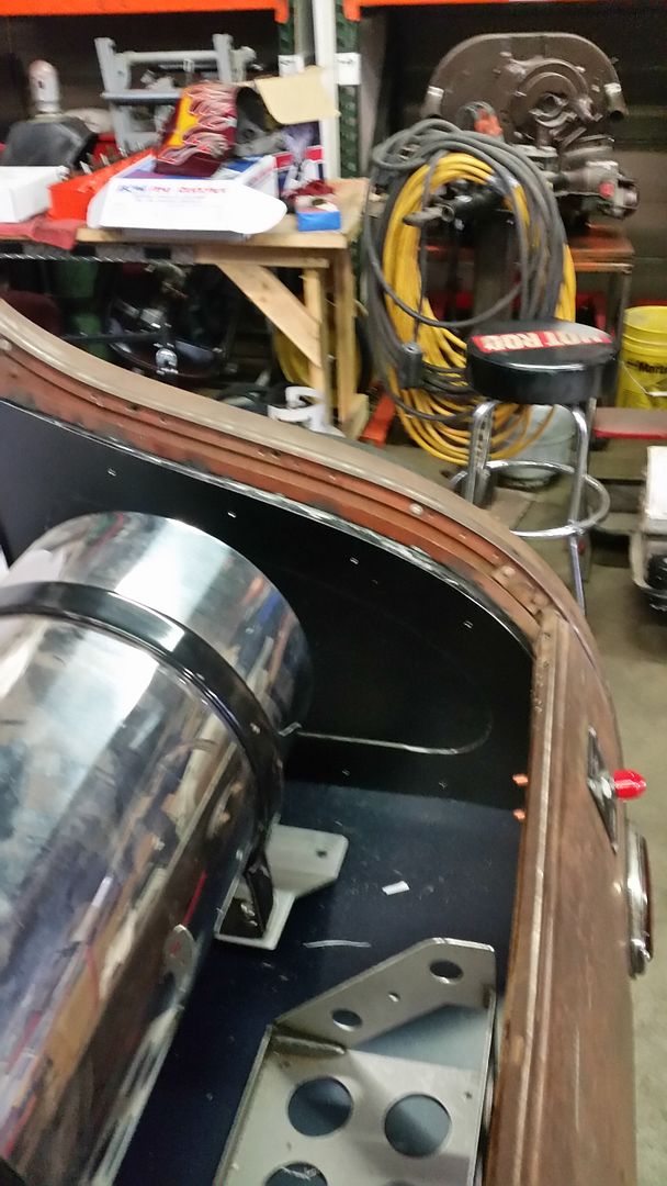

it dont look like a lot of work but it was. We are gonna cut the body into chunks and make the entire body removable with quick release pins, so none of the bracing can connect to the body. It has flat stock that follows the curves of the body and is only welded to the frame. The trick is getting the bracing super tight to the body yet still letting the body come off.
The pannels will be aluminum and copper sheet, aircraft rivited and bead rolled. Its gonna pass NHRA tech AND look dam good doing it.
