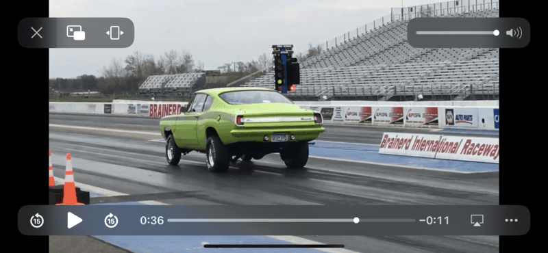

I watched that video around 10 times trying to figure out what is going on during your initial hit. It’s pulling hard right and coming back left when the chassis rests. If it was pulling the wheels more it would probably make you abort the pass. I’m getting ready to go racing tomorrow but if someone could watch it on a bigger screen it would be more obvious. Any chance a shock is bottoming out, are the frames tied?
Is that the passenger side rear shock I’m seeing in this picture. Stretch it bigger with your fingers

Thanks, I'm glad someone caught that. The car is lifting the left tire but it doesn't lift enough to get the right tire off the ground, which is causing it to veer to the right. Then I'm correcting it, which is where the left turn is coming into play. The car seem like it's twisting, but it has frame connector in and is solid.
I have a set of double adjustable Vi-king shocks on the way. I felt like that shock setup was causing it to roll over on the passenger rear, lifting the drivers front. Not sure, but that's how it felt.

No, have been reading about that. Will put it on the list to do for sure before we race again, but it's definitely not the cause of the right pull if that's what you were thinking. As mentioned above, it's because the right tire stays in contact with the ground steering the car to the right.
I looked at that on the big screen trying to figure it out myself, it's actually the driver's side leaf spring. If you watch on a bigger screen, you can see it expose itself as the car loads up.

need a loose shock setting on the left and stiffer on the right.
I had a super stock spring 9 sec car years ago, had a chassis guy watch me. Fixed it in one pass( staggered air pressure in rear tires…car about went around at half track.. but straight out of the gate.
Even cheap CE 3 ways, like i had, can fix that. My left rear tire was actually coming off the track at launch

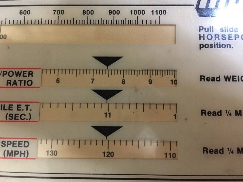

The Moroso slider shows your speed/ET to be well matched.
Imo, the 60’ time is also in line.
But the power it’s showing at 3k lbs is way off.
The weather finally came around, and gave us a few hours to run the car before rain showed back up. Was able to run the car three times. First two were shake down runs that I shut it down half track. The entire car is new and I had no idea what gremlins lie in waiting. The only video the kid was able to get was of the second pass.
Running a two-step off of a line lock. Only launched at 1800rpms instead of the 3500 it is built for. We'll be goin back this Wednesday to play with it more. But it's obvious the Mopar drag shocks are getting way over powered. All week I've been in discussion with the guys at PST for some double or triple adjustable shocks.
Anyway, third run was 10.99 as I short shifted the first two and hit the rev limiter in third before the end of the track.

But I'll bet you have 150+ more horsepower at 5000, than at 3000. If it hooks with 150 more horsepower, it WILL run harder.
